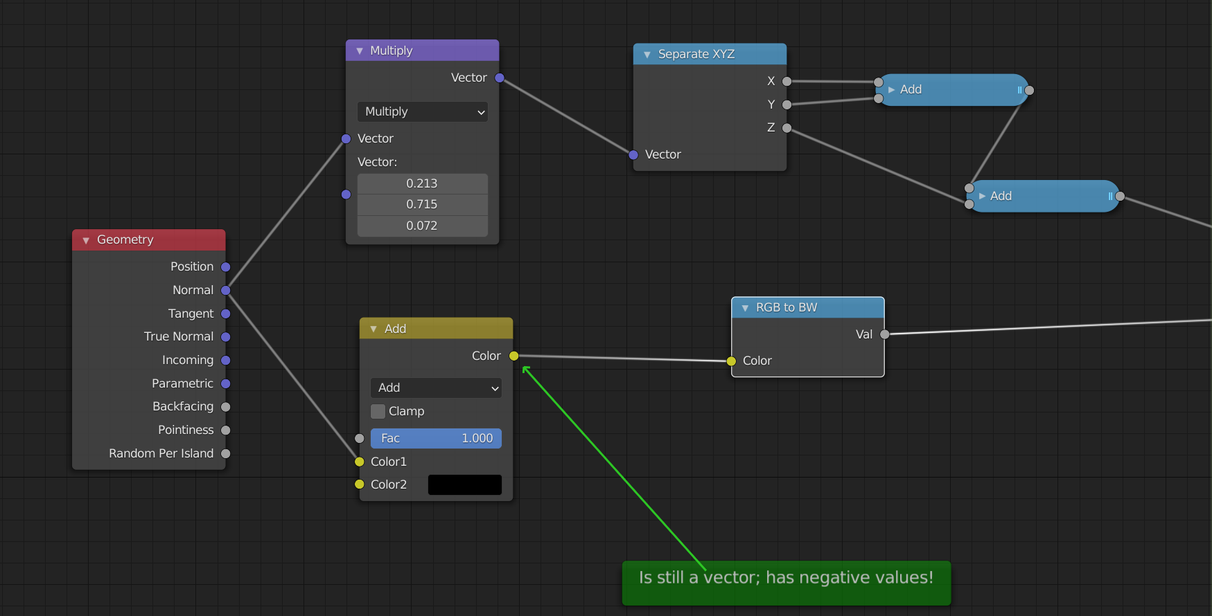

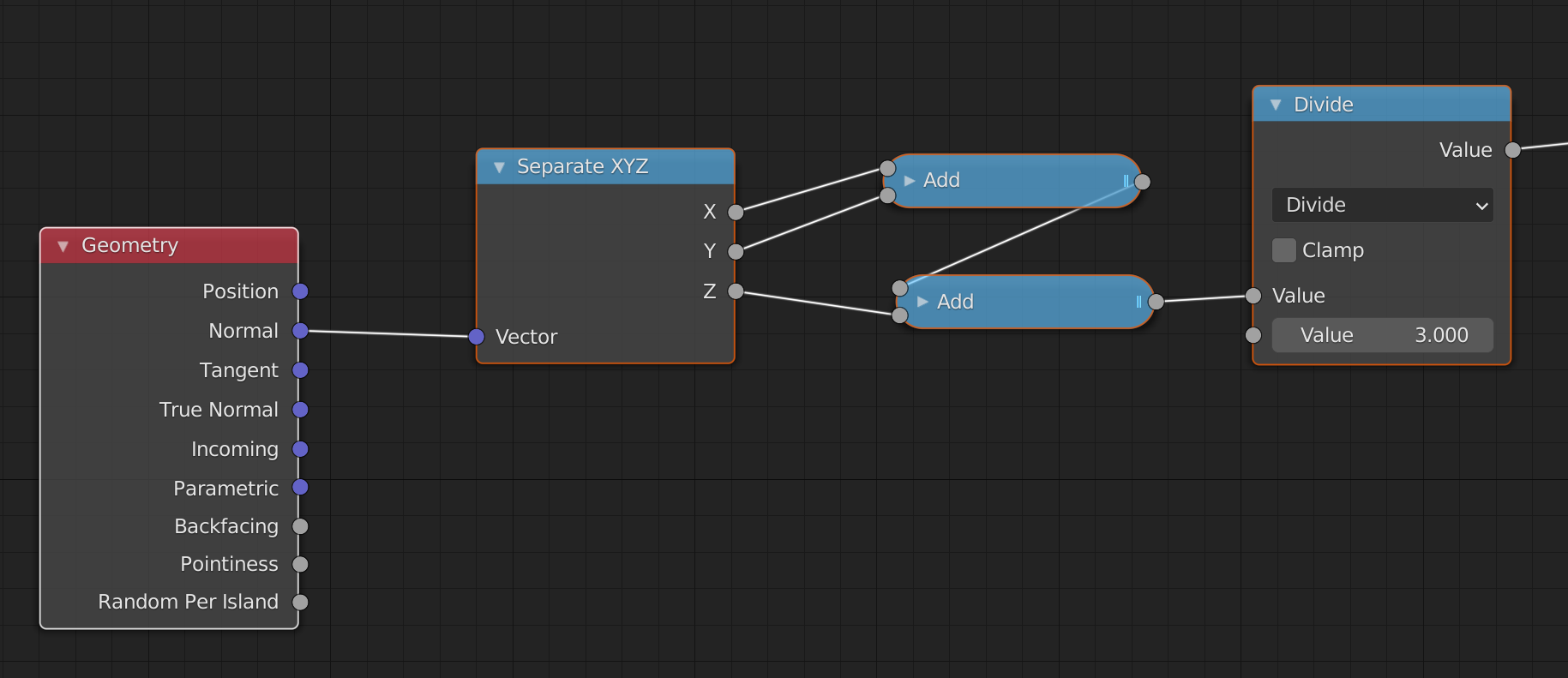

I took me some time to figure out what is happening, because unlike when you plug a color into a value and Blender uses the Luminasnce of the color, when you plug a vector into a value, Blender takes the average of the X, Y and Z. Like this:
But things get curiouser and curiouser; When you plug the Vector into a MixRGB Node first, then the output of that MixRGB Node is a vector, but when you plug that into a grey socket, Blender uses the Luminance formula on the X, Y and Z values!
So these two flows are the same:
