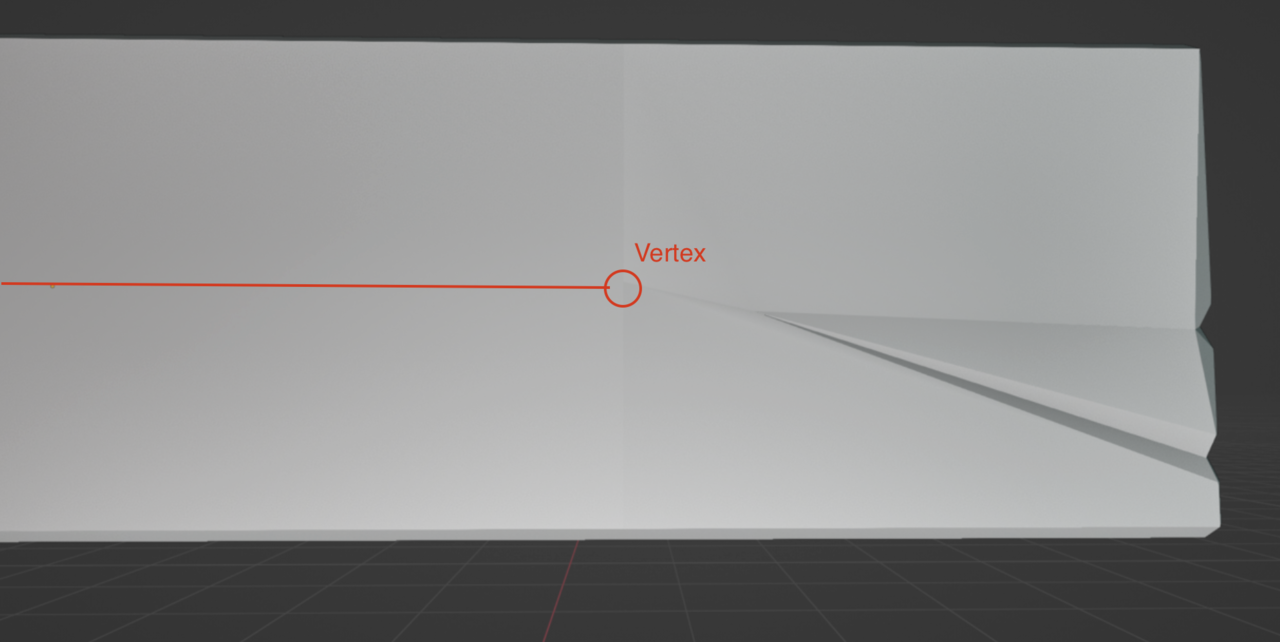

Ok I see you posted an image. That looks like two possible things to me. First possibility you have a long Ngon there where that vertex terminates. Try continue it with a cut:
Also perhaps that whole side is not entirely flat. Try selecting the faces you want to be flat and scale them in the X axis. So “S” then X then zero.
