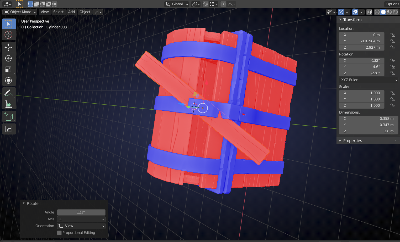

    Works almost like a charm, the only thing is that your Normals of all the planks are flipped, so you need to align view to bottom of the selected Face:
    Or even better: fix the Normals first.
    Select all with A in Object Mode. Switch to Edit Mode and press SHIFT+N. Then All your Normals are correct (facing ‘outwards’)
