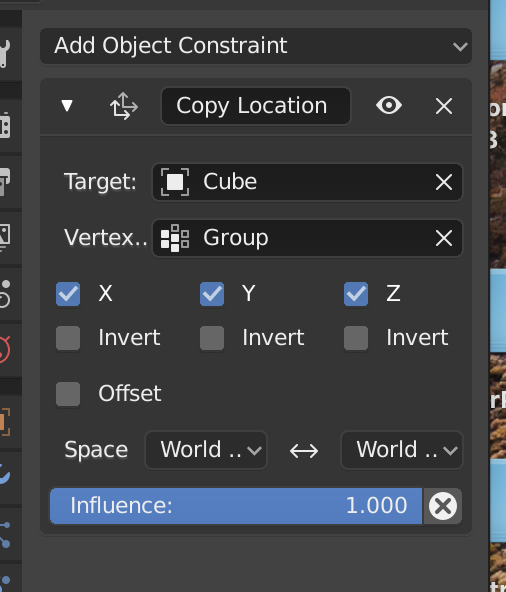

    Hi,  I agree it acts like a bungee cord.  It works,I think, if you make a vertex group out of the face on the domino and then instead of parenting use the copy location restraint  with the target as the domino and the vertex as that group.
