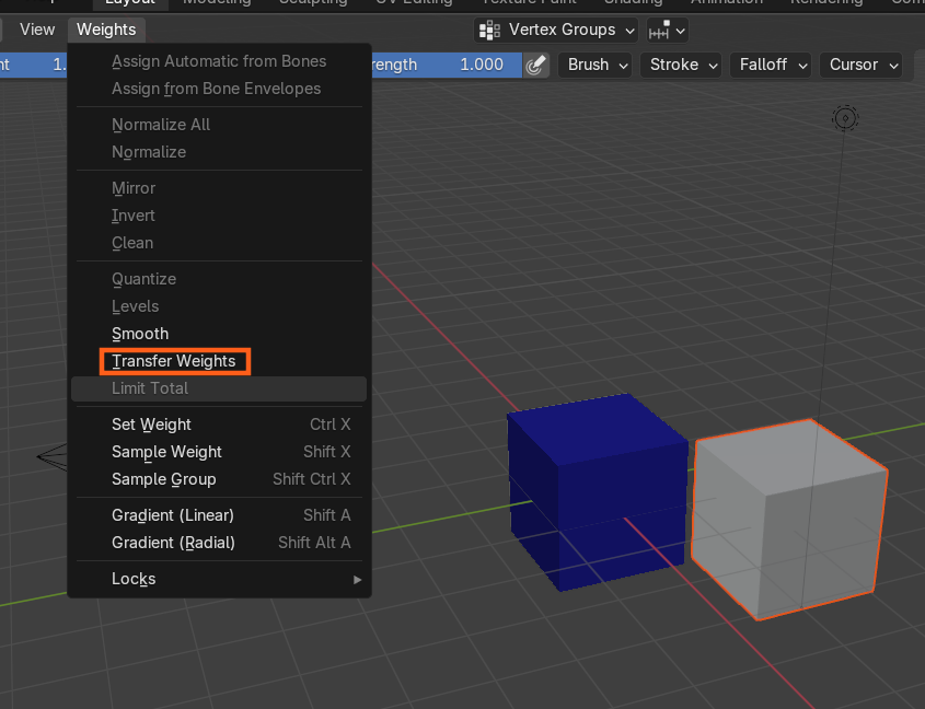

    As for transferring weights – there are 2 ways.
    Transfer the weights in weight paint mode – select both meshes, then in weight paint mode go to the ‘weights’ menu and choose transfer weights.
    I can’t remember the correct order you need to select them but I think the tool tip will tell you.

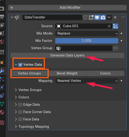

    The other way is with the data transfer modifier.
    Set the Vertex Data on, as well as Vertex groups, and then you can change how it is mapped.
    The generate Data Layers button will create the vertex groups it needs on the mesh,  But once the settings are looking correct, you can apply this one.
