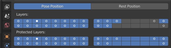

    The hidden bones are because they are on layers that are turned off
    See that area that says “Layers”
    Shift click them all in Pose mode.  This will turn all the bone layers on but the rigger will have the controls separated into logical layers.
    I usually write a UI script that display them more easily.
    Who rigged it? did it come with a script?
