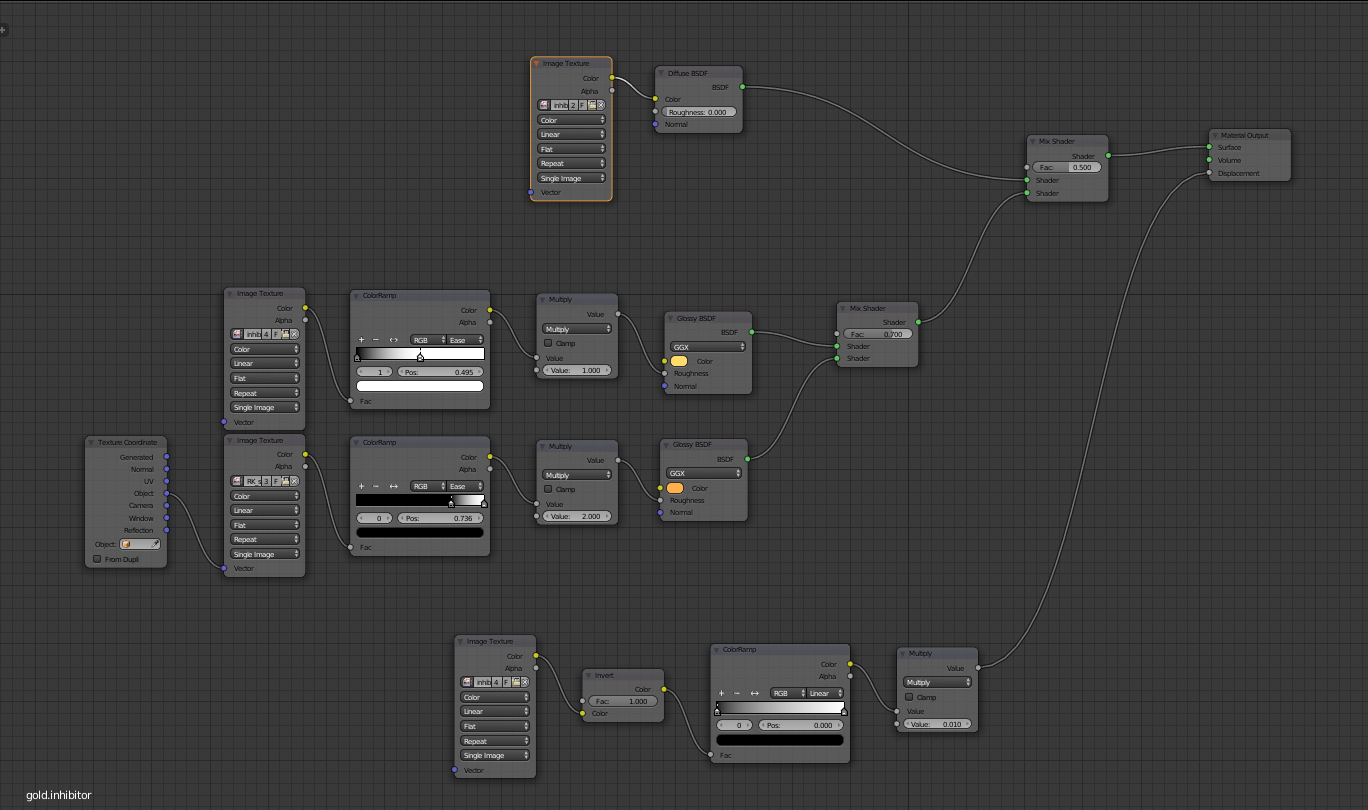

    //Oh, quick edit:
    Here are my node setups for the gold material. First screen is from the top image and second from the lower image. As you can see in the better-looking-image the material is much simpler built as most of it is controlled in the texture maps.
