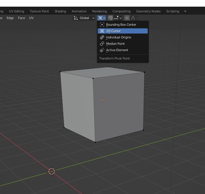

Hey there,
It’s possible that your pivot point might be set on your 3d cursor, and maybe your 3d cursor is in the center of your object. If you change the pivot point to any of the other options, that might solve the problem.
