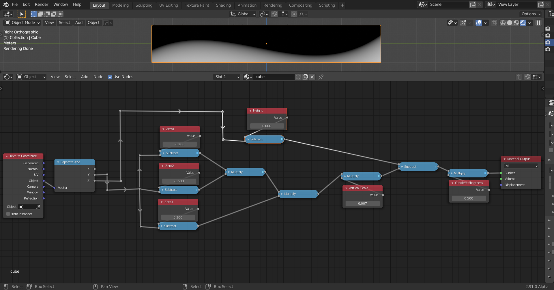

Or,using a cubic:
Just fill in the Y values where the Z should be zero (or a, if you change the Height to a).
I left out the Noise here, for clarity 😉
