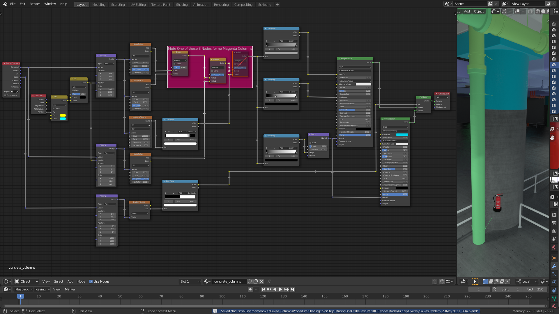

Ok, I could “solve” the problem by muting one of the last three “MixRGB” nodes (mode “Overlay” and “Multiply”; see magenta frame below):
Muting one of the first two “MixRGB” nodes (mode “Mix”) doesn’t remove the magenta column shading.
File with one column only is here.
