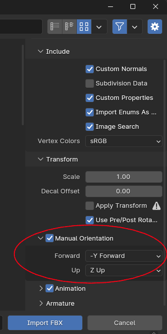

    When importing into Blender the .fbx file should contain orientation data.
    Manual Orientation should be disabled (default) in the import settings to use the data in the .fbx file.
    If you are having issues, you may need to enable Manual Orientation and specify orientations.
    What I set below is Blender specific orientation, what you use may be different, depending in which software the model was originates from.
