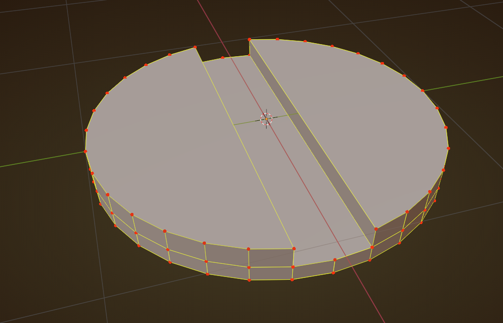

    As simple as it looks at first glance, this kind of screw is (almost?) impossible to make perfect with Subsurf modeling.
    The logical thing to do, is to not use a Subdivision Surface Modifier (make the screw as a separate Object), something simple like this:
    This was made from a default Circle (I know, it’s easier to start with a Cylinder…); the  number of Vertices influences the width of the slit.
    And long live the N-Gons! (I remember the time when N-Gons weren’t yet supported in blender….)
