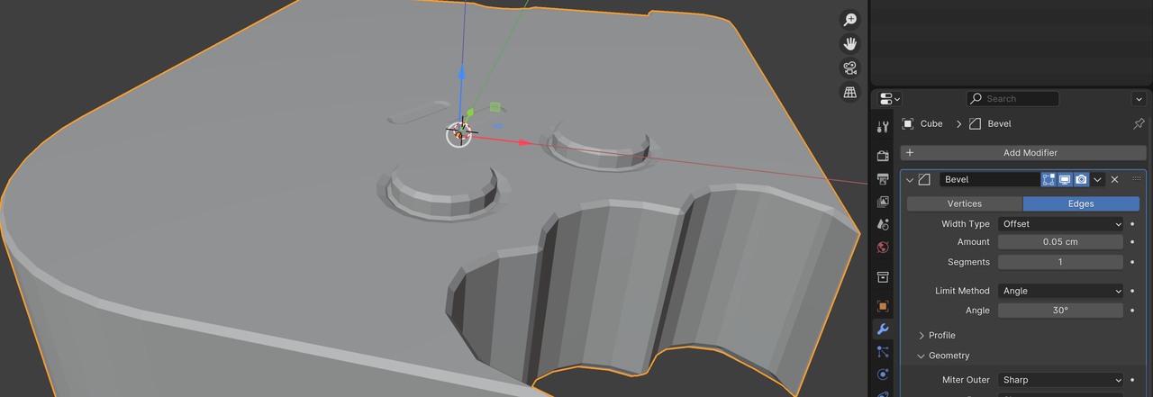

Beveling works fine:
You will need to do some clean up:
You have some inconsistent Normals: in Edit Mode Select all (with A) and then SHIFT+N.

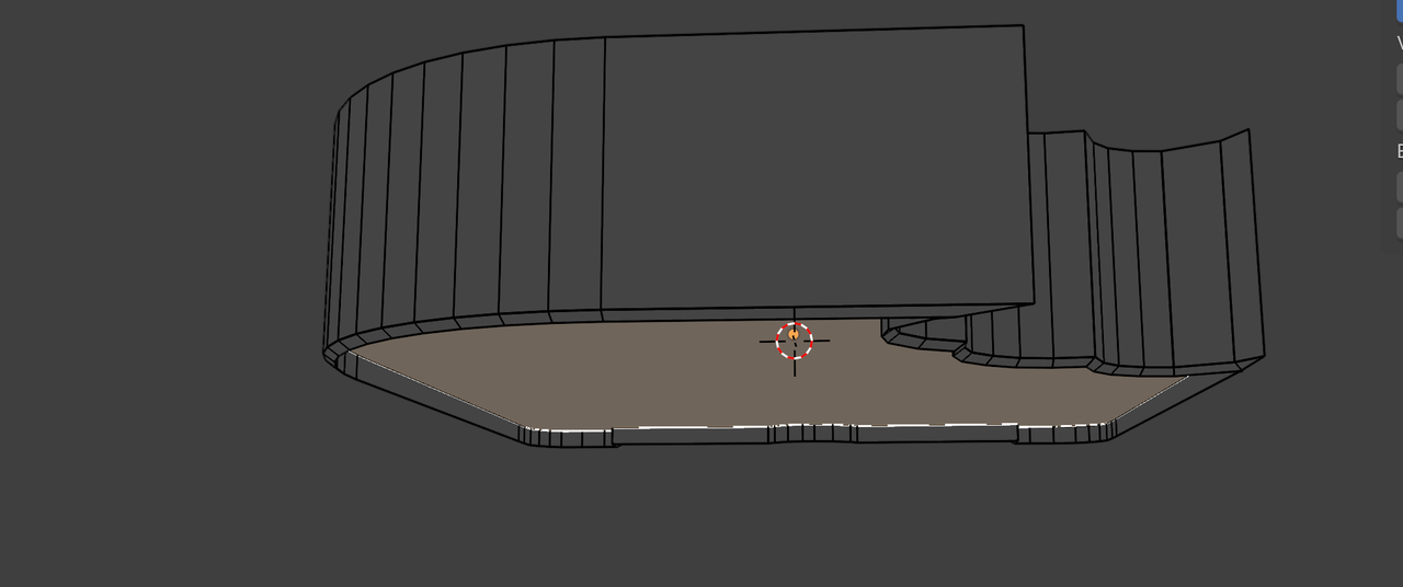

Also the bottom of your console needs to be re-aligned:
and then you”ll need to Merge By Distance again.
There are probably some more modeling mistakes, so I’d really recommend to start over, but that’s up to you.
