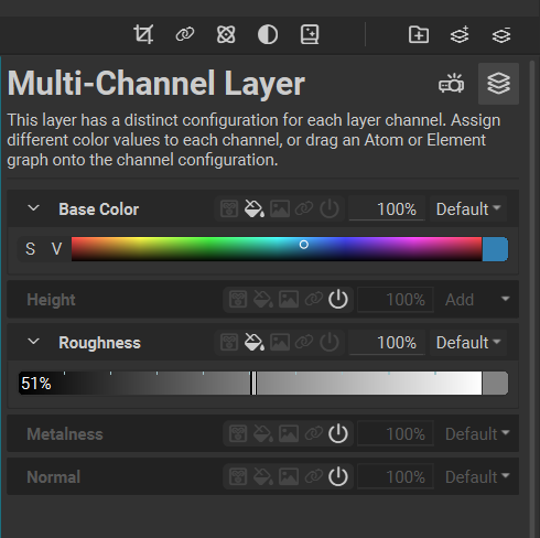

    So the UI will be slightly different as this was recorded with an older version of InstaMAT, thus why you likely won’t be able to see the Seed option.
    What channels do you have visible on the Ridge layer? I know I have you turn off everything except for the Height and AO. Perhaps if you turn the colour channel back on for now, this can help us troubleshoot to see what is going on. As well, if you hover your mouse over the mask layer and press “S”, you can solo that layer and visualize what the mask is actually doing. That may be a good place for us to start. 🙂
