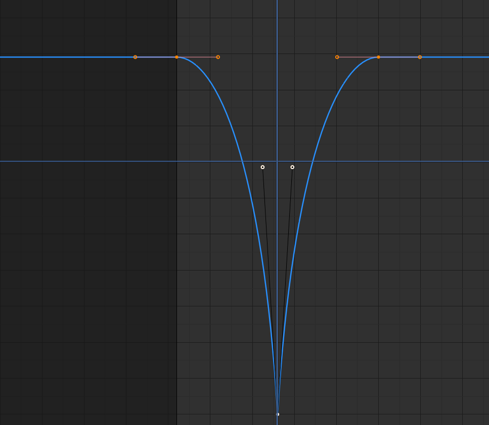

    Hi @CCWieland ,
    If you match the handles exactly, then you get what you want, but there are three keyframes that can influence the curve:
    I think that your handles on keyframe 1  are not symmetrical/matching keyframe 25. If you have perfect symmetry in all your handles around frame 13, then the curves will also be symmetrical and therefore the Motion Path will match.
