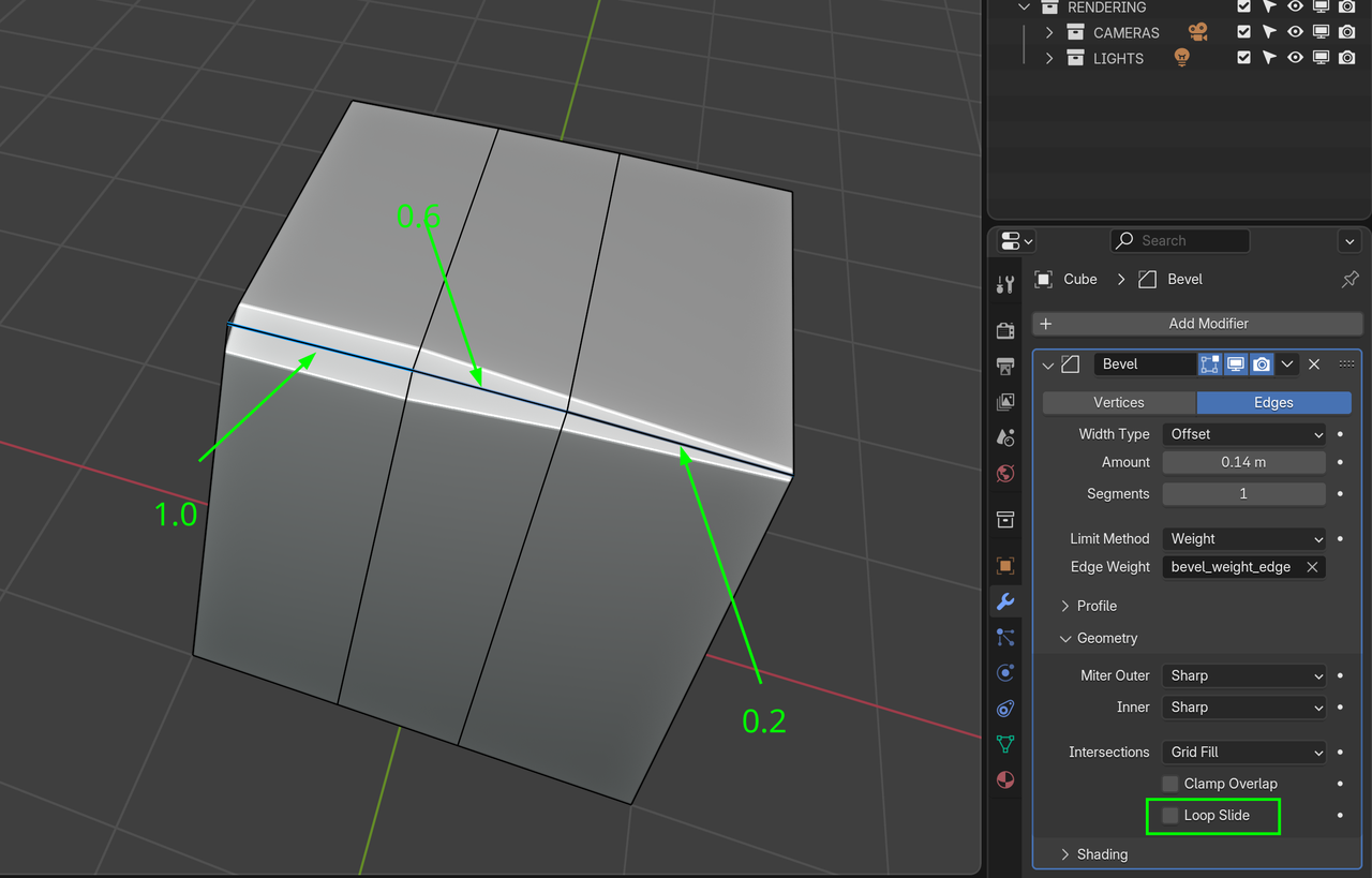

    It depends on the exact situation and also on what you expect. “The results look screwed up” doesn’t really tell me anything.
    But what you can try, is disabling Loop Slide:

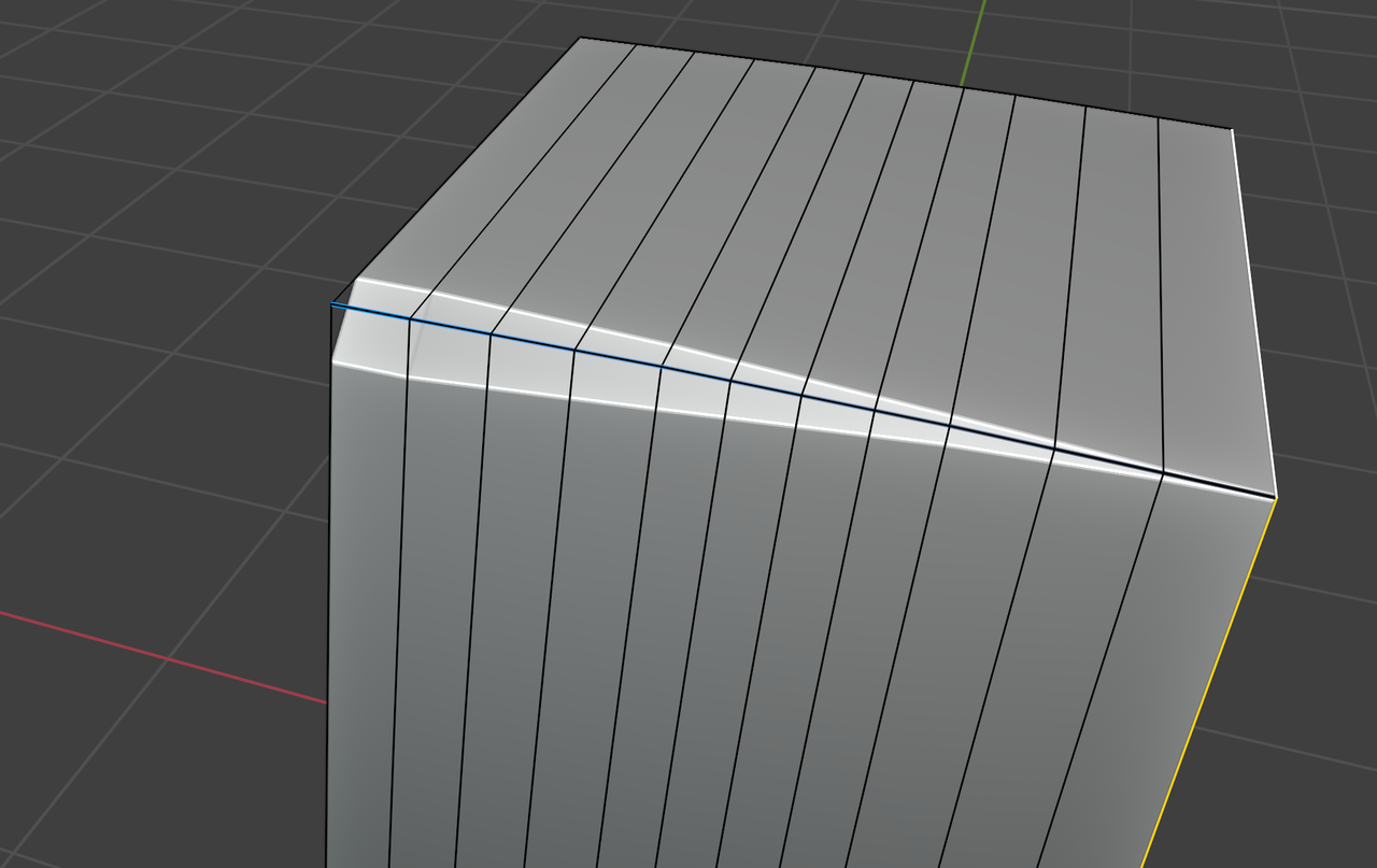

    And adding more Geometry might also improve things (again, depends on the situation):
