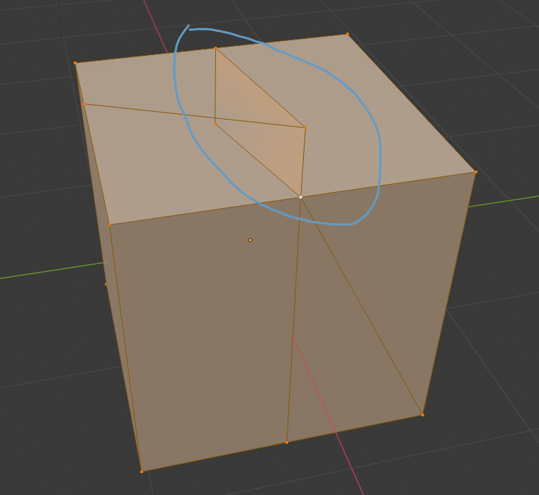

    You can probably see that something is wrong here:
    Look for things like that. Use ALT+M > Merge by Distance to get rid of double vertices ( in the latest 2.83 the shortcut is changed to M > Merge by Distance). And ALT+N to Recalculate Normals.
