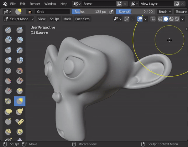

Ahh nuts, you are correct. This functionality has changed with 2.9 with the introduction of Face Sets. Instead you can make your edit-mode selection into a face set and tell Sculpt Mode to only modify said face set:
