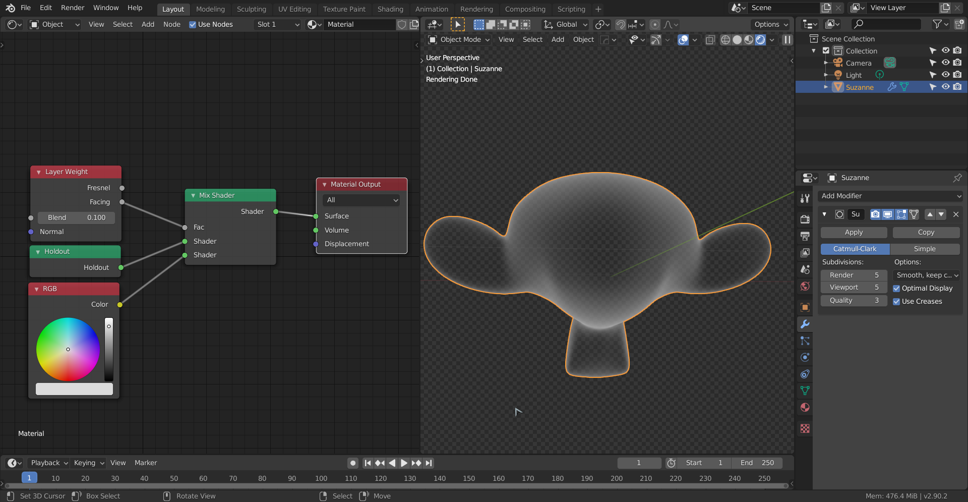

    I honestly can’t see what you could be doing wrong:
    Are your drivers up to date? (Mainly the graphics card.)
    Your Blender also looks a bit different from my 2.82.7, (I don’t have those 3 ‘lines’ below Options in the 3D Viewport, but I don’t think that has anything to do with it.
    (I know the Screenshot is made in 2.90, but I also checked this in 2.82 to rule out some kind of bug)
