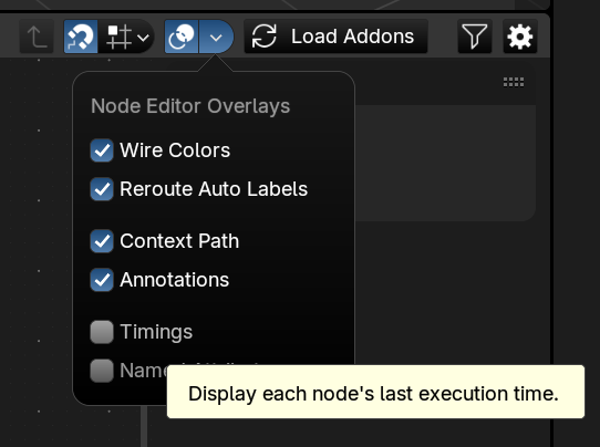

    Dwayne is right, you can turn on the timing option in the node overlays and it will show the processing on each node if that’s what you meant.
    From what I’ve seen so far it’s heavily depending on the node itself with some having almost no impact at all and some are super heavy. I would image you wouldn’t want to duplicate something with a boolean operation attached to it. Then again what do I know about this voodoo stuff 😀
