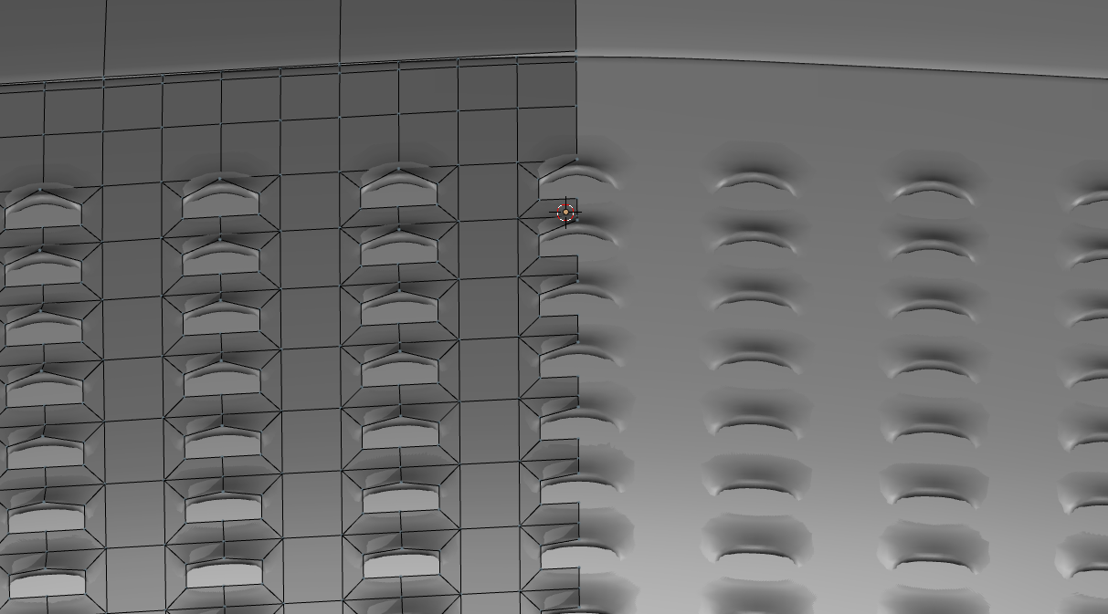

    @baukepost first cut the main panel shape out. duplicate it, then go in to the edit mode of the duplicate, use shrinkwrap and target the original. then subdivide the copy, enough times that you have enough geometry. similarly how i punched the holes in my roof and and boot. (yours cirles and you can propably do with just 6 sided circles with sub-d
