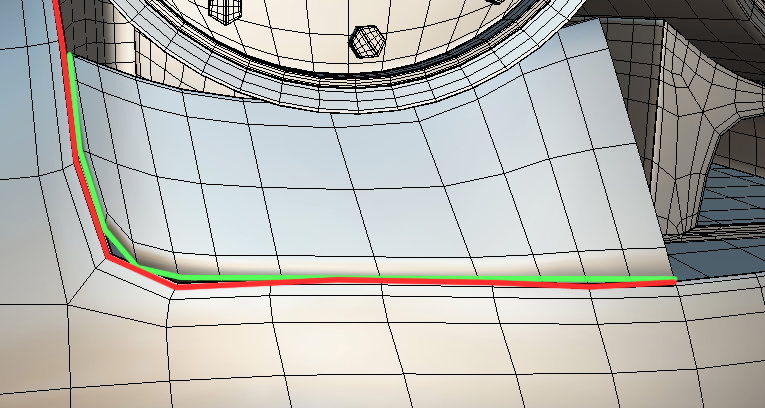

    @dieedi Excellent job! From your first WIP post to end of week 2, your steampunk car has come a long way. It’s got a style that reminds me of the old 90’s animated batman show, which I adored. And the topology is very clean. I’ve a couple minor notes; nitpicky notes:
    First, the trunk area is a a little wobbly on the car body side (red line), while the trunk door edge is not (green). Evening out the red edge would be 👌

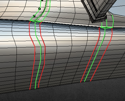

    Second, I see some holding edges on the side that make the topology unevenly distributed and it shows in the smooth shaded view. You could kill them with a diamond junction to remedy this (green is new topology, red is removal).
    Remember those are nitpicky notes. Overall its a solid model! A in my book.
