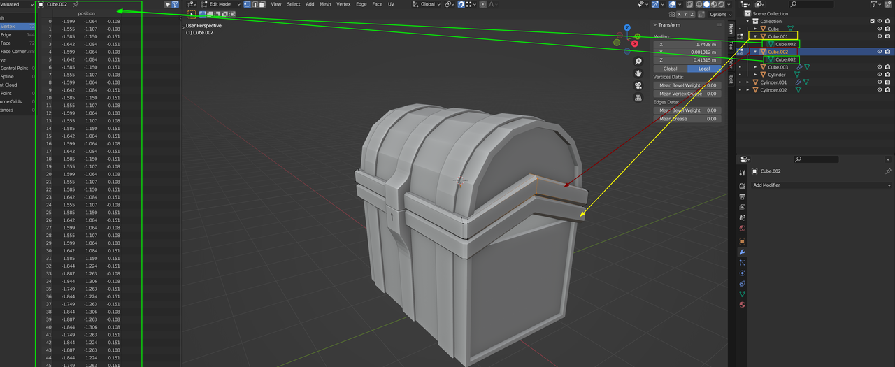

    Hi Skyler,
    The lids are linked in your file, meaning that anything you do on one of them will also happen on the other.
    This is your file; the Object Cube.001 (yellow) uses the Mesh Data (Vertex Positions) of Mesh Cube.002 (green). And Object Cube.002 (red) also uses the Mesh Data of Cube.002 (green)Links.png
    A Loop Cut made in one of those Objects, will also be made in the other, but if you are in Edit Mode on only one of them, you won’t directly see that that same Loop Cut is made in the other.
