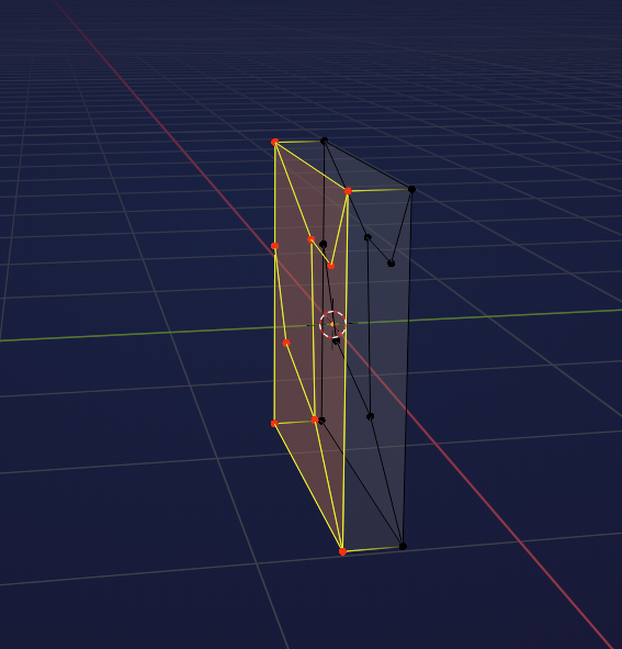

    If you don’t have a relevant Local Orientation for the part, make a Loopcut through the middle:
    And use that as a Custom Orientation. Then you can SHIFT+D (copy) and S, X or Z, -1 (paste) remove original if needed and M > Merge > by Distance.(Watch out: creates inconsistent Normals! Run SHIFT+N!). Doesn’t work in all cases, but in most.

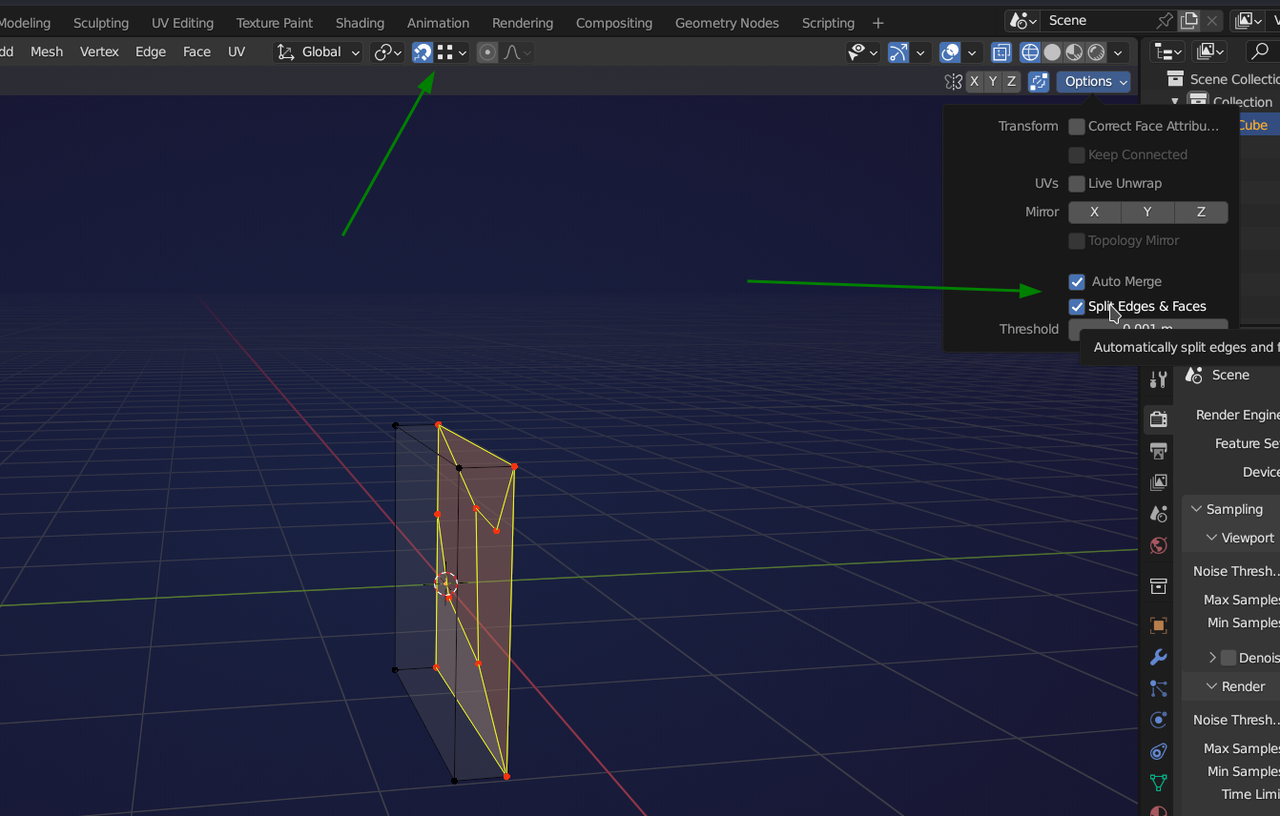

    Special Case:

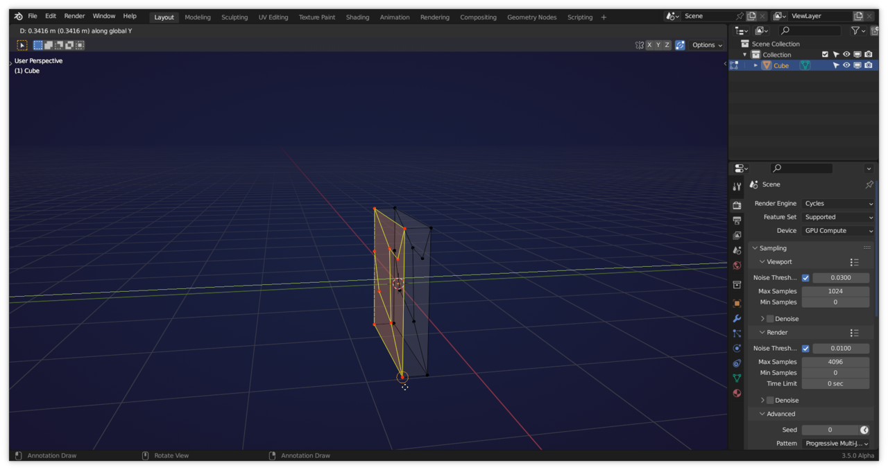

    SHIFT+D, Y:
    gives:
    Now that’s what I call Blender magic….
