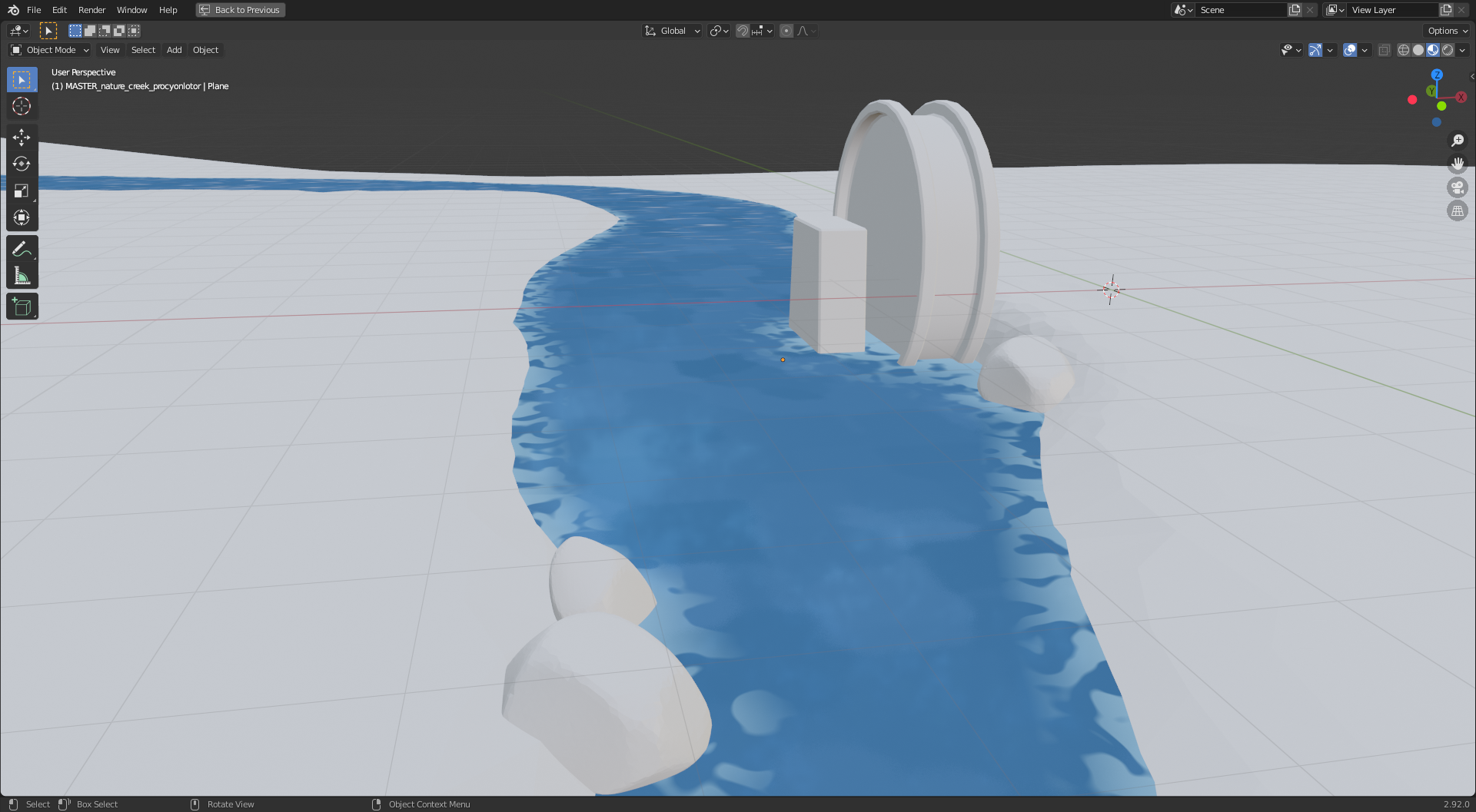

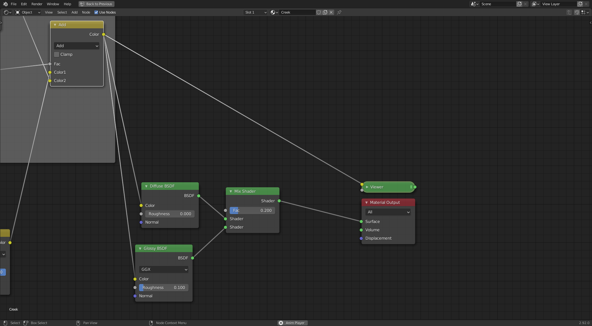

    Excellent job to produce this shader @procyonlotor . One note I made was the lack of reflections, so I took a look at the nodes. You have it plugged in to a viewer node. I did a little test and added a mix shader , a glossy shader and a diffuse shader to get some reflections, I’m sure this maybe just an oversight, or your intentions for week 3, you obviously know your nodes.
    Here’s what I added but I didn’t save it though.
    You could add another mix shader and a translucent shader, but won’t look to good at the moment until the ground and rocks have been textured and shaded.
    Would be nice to see some displacement from the ripples of water , how? , well I’m glad it’s not me with the problem.
