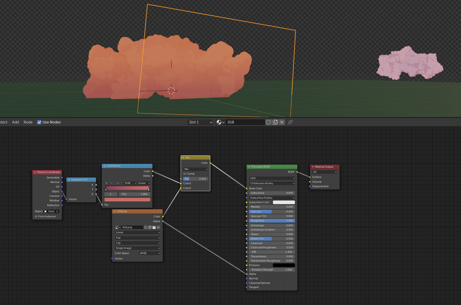

    Today I learned about a workaround to a (maybe) bug in Eevee with image planes.
    If I use the “import images as planes” addon, the planes pop in front of each other using the object origins, rather than intersecting in the way that would be expected. If I set the Blend Mode to Alpha Clip rather than Alpha Blend this doesn’t happen anymore. So that will save me a headache.
    Also, I set up a gradient control in the material. I figure the PNGs can be used for the luma only, and hue-shifted for different bushes like green and blue-ish ones. And then the gradient can also be tweaked to give more variation.
    Old, hyper-pink bush shown for reference.
    Setting the material to a Roughness of 1 prevents the “glossy photo” look, since the lighting is already included in the PNG.
