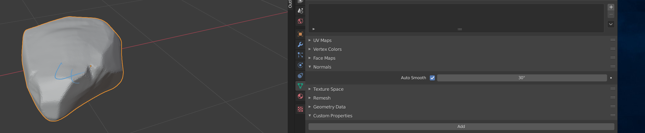

    Dude this is great!
    From what I can see you might have a bit of geometry inside your model, or you’ve joined together some vertices you didn’t mean to?
    Apart from that try flipping your normals, or recalculating the outside normals.
    When it comes to smoothing, in the right-hand panel make sure you have the object selected then go to object data properties (the green triangle) and turn on auto smoothing under normals. This will stop any over-smoothing.  Ignore my rock that is a sculpt not low poly
