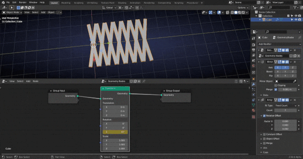

    Want to make a cuckoo clock and was thinking about how to rig the mechanism, because I’m not too worried about the modeling, but this is something that needs to be animated I think.
    Couldn’t get it to work (easily), but then I thought, hey, we have Geometry Nodes now:
    The trick being that I can now rotate the Cube before it gets Mirrored and Arrayed 😉
