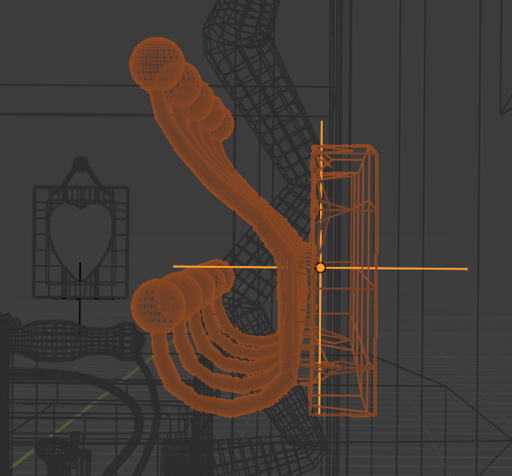

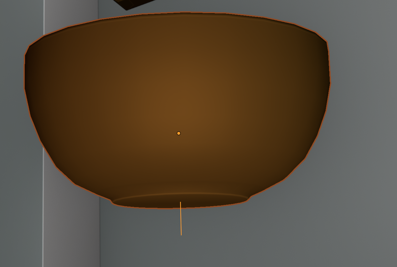

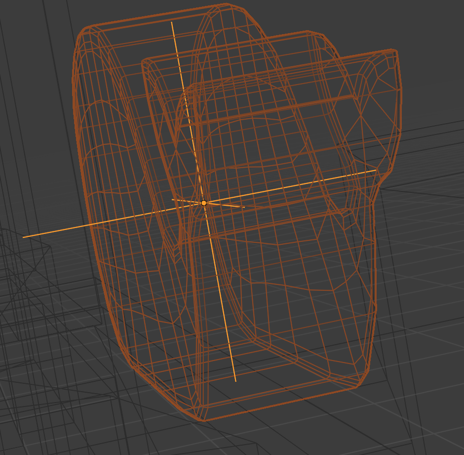

    @yukinoh1989 Yukino, a small tip. Try to place object origin points where they most make sense they’d be. For example the bowl, it’d be best if it’s on the bottom, that way using snap on a face it will instantly snap on the surface of a table or something like that.
    Same for the whale or the thing with the hooks. If the whale is a decoration that stands, then the origin could benefit with being at the bottom. The dresser hanging thing would benefit if you place the origin point at the back, since that goes placed against a wall.
