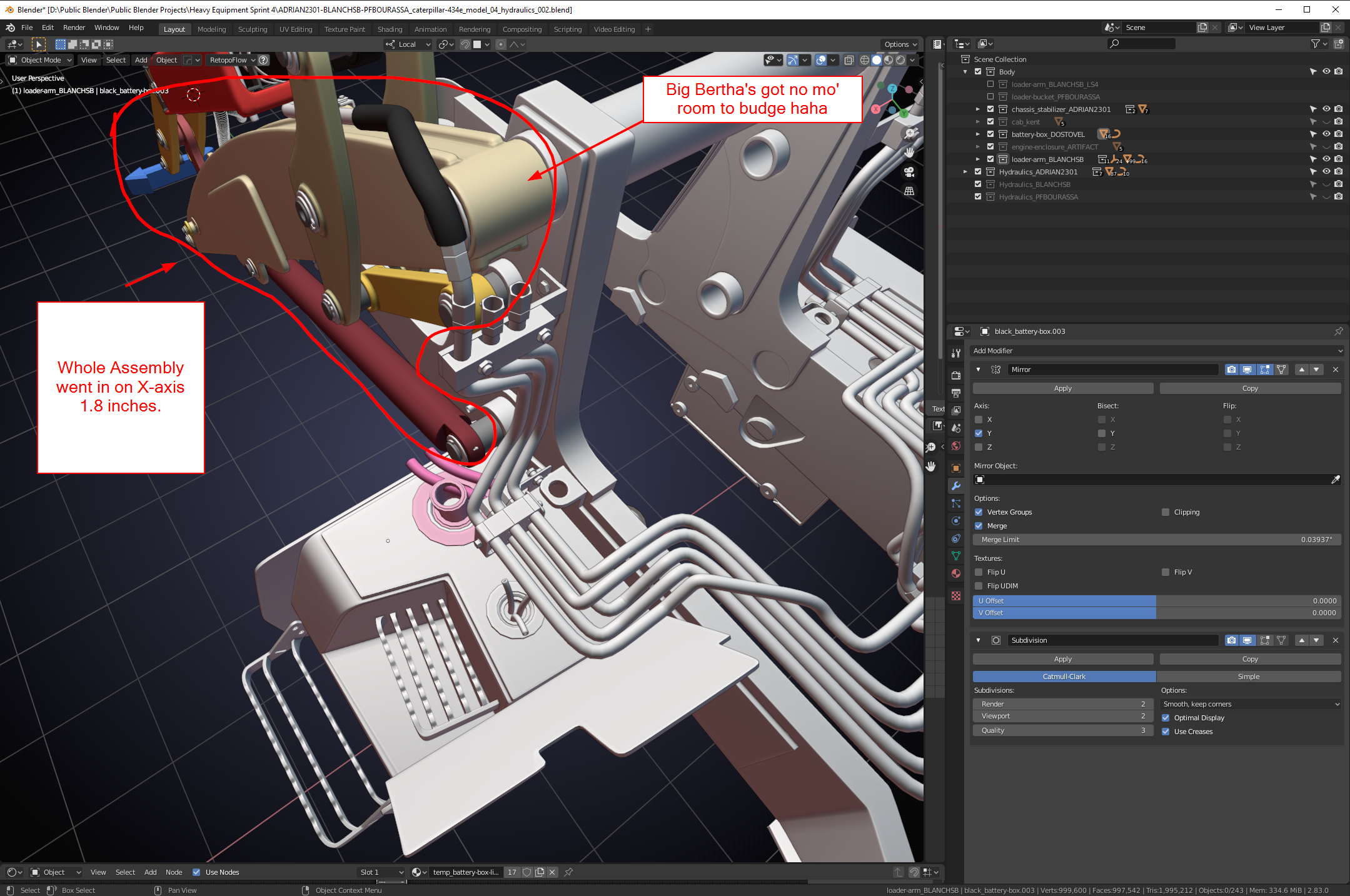

    Well I shoved my pieces over by 1.8″ towards the center so @pfbourassa You’re flanges should only need to move over 1.8″ in the X direction to mate up with mine again.
    @dostovel I think that should help a bit if you’re moves out. If you could move yours out about 1.5″ or so that should be enough, OR I could do some trickery with the hydraulics and make them overlap vertically.
    Also @adrian2301 . I moved your upper hydraulic clamps over just a bit because they were causing hoses to be hitting into the main loader arm (big Bertha) They moved down Z a smidge and over Y a smidge. I can give you the dimensions that I moved if you need them but I don’t remember off the top of my head.
