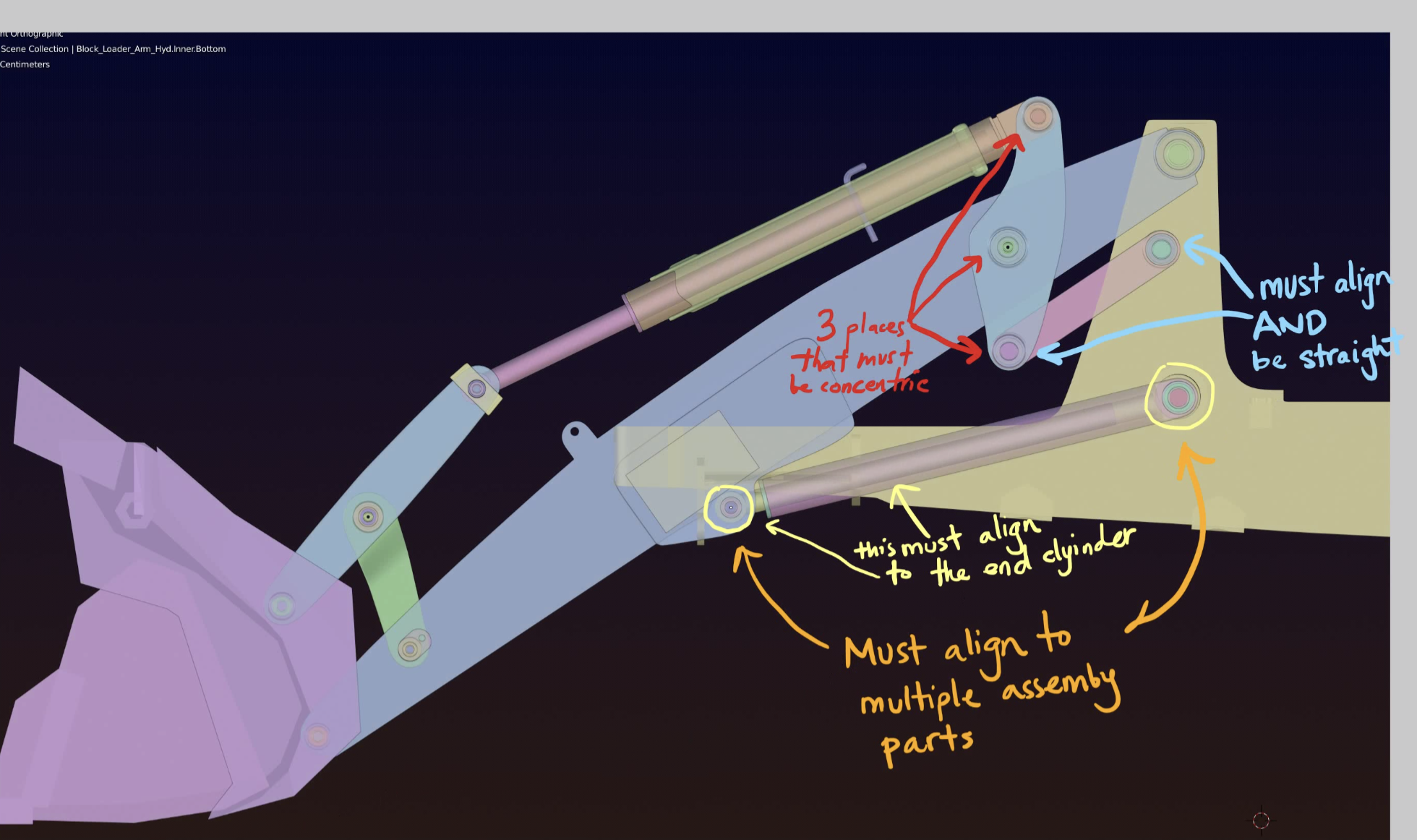

    While I think I know what you mean, could you post a screen shot of 1 or 2 situations as you described? Indeed it sounds like a common task and thus helpful for the DOG Pound
    @theluthier
    Yeah I can do that: 4 different parts the must align in similar ways. Hard to explain but hopefully the picture below makes sense. I wish there was some sort of concentric snapping between two objects that have circles. Would make it a little simpler to align them all.
    one of my biggest pains was aligning the hydraulic main body from one pivot location on the right to the other location in the lower left  (It is the note in yellow, regarding the part in pink/purple) and making the “rod” also align perfectly (the yellow part inside). Somehow these Two parts got out of alignment with everything even each other and it took me forever to figure out how to align them all again
