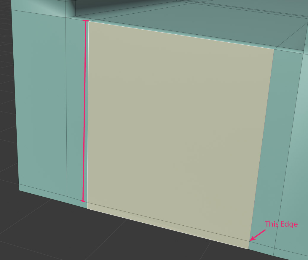

That face shouldn’t go all the way down, it should stop at this edge.

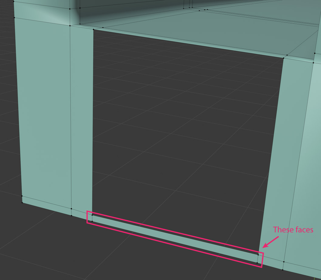

If you delete it you will see there were faces down below, occluded by the large face.

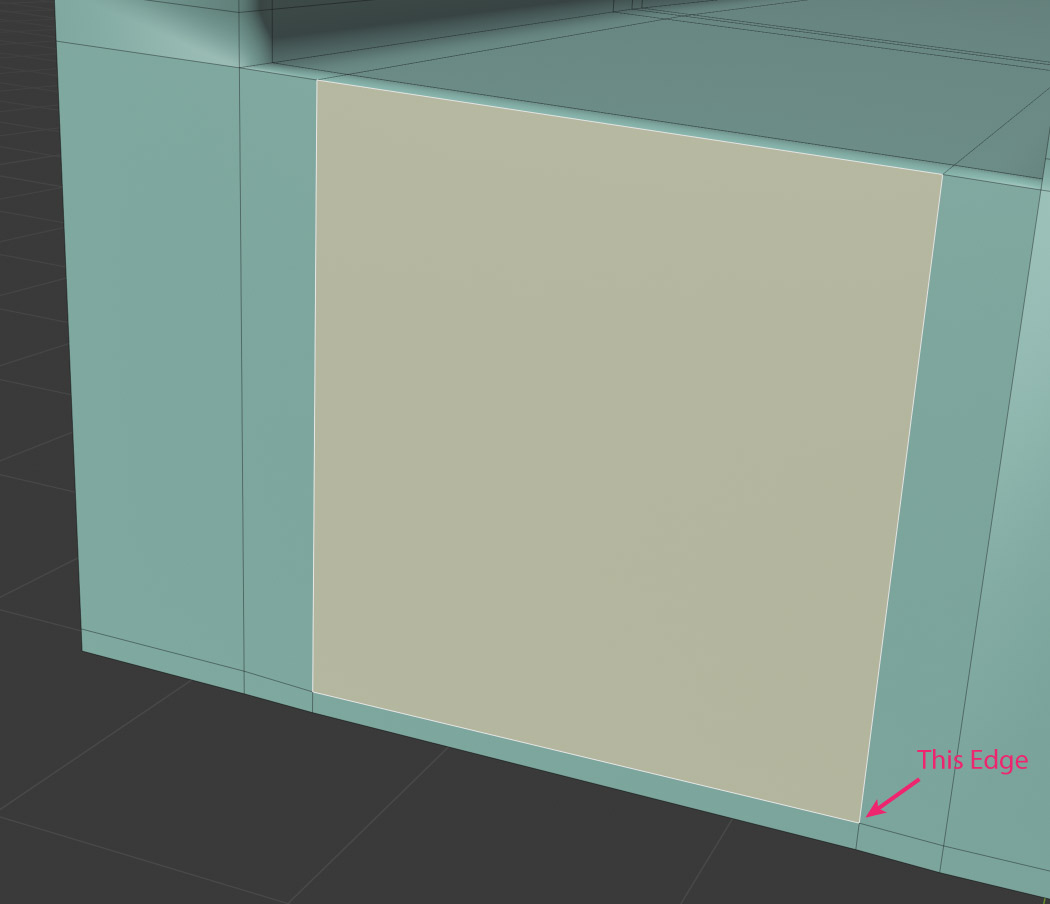

Now fill the face and it reaches the edge it is supposed to and it stops.
