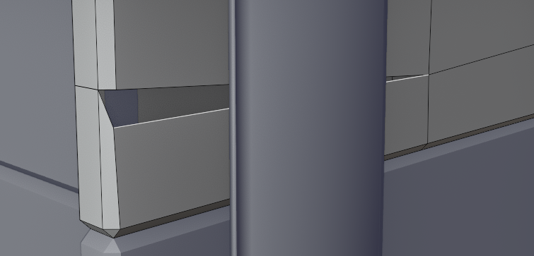

    Hi, you have just encountered the second of the two main causes of all modelling issues (the other being: ‘flipped Normals’).

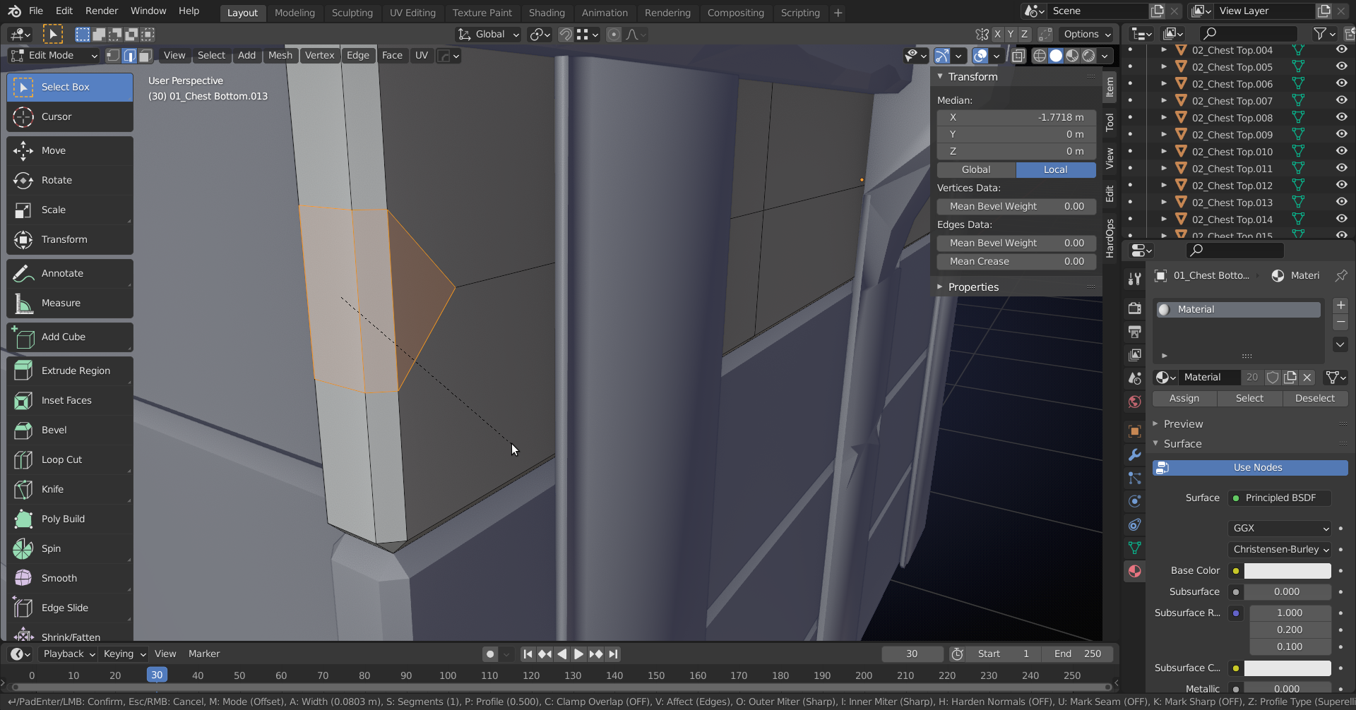

    You have double vertices (more than one vertex in the same place):
    That is why the bevel won’t work.

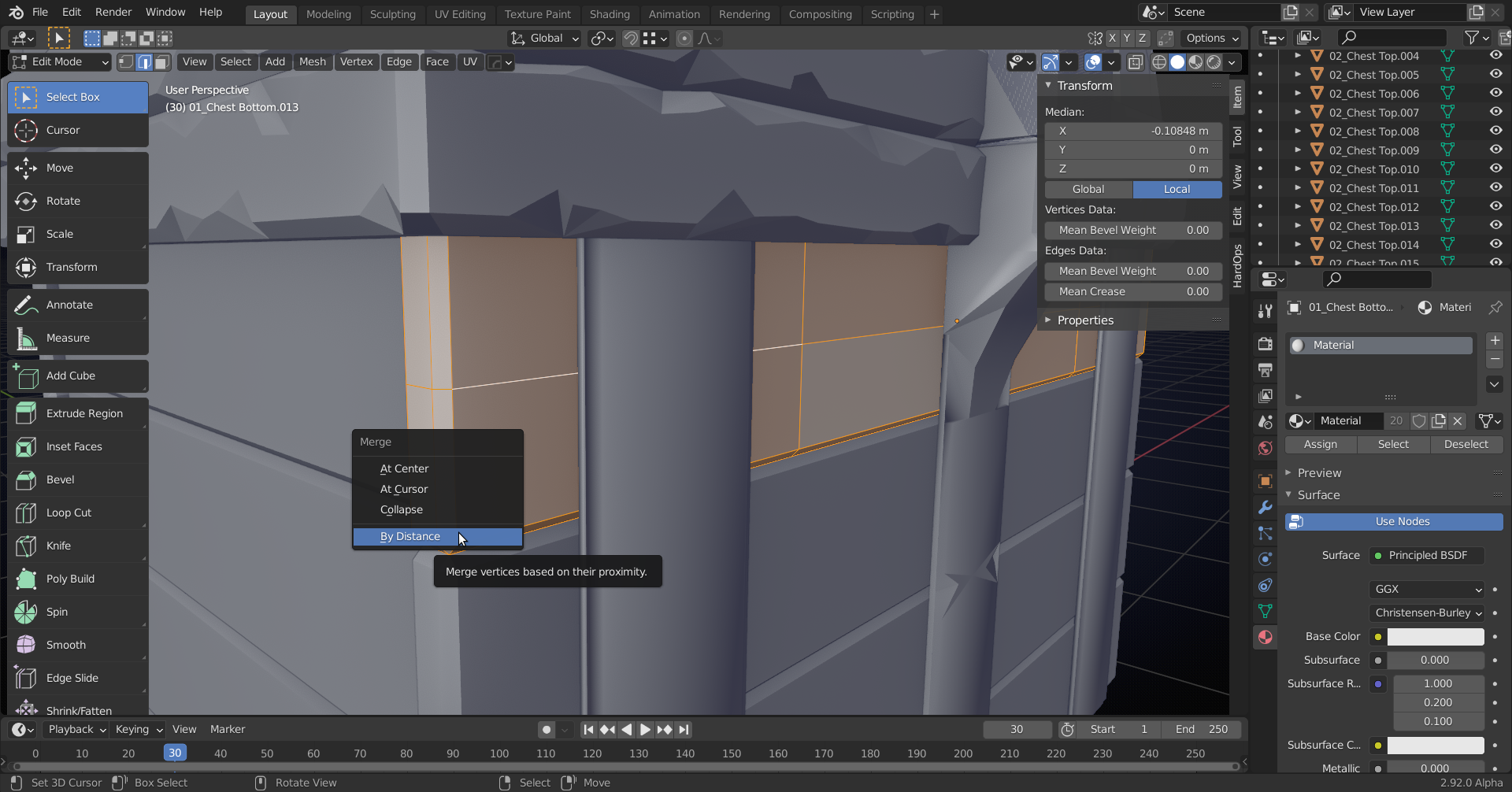

    Solution: select all and press M > Merge by Distance:
    And then you can bevel away:
