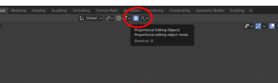

    It looks like you might have proportional editing turned on.
    At the top of the screen is the button to toggle it on and off and also the hotkey is ‘O’, Its easy to press it my accident.
    If its blue like this its on, click it to turn it off or use the hotkey as mentioned.
    hope this helps, let me know if you need anymore help 👍
