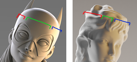

Your light match is quite good as well, though with one overarching note: Breadth of light coverage. In the source render, all lights are concentrated mostly as rim lights. It creates a unique setup; very strong for characters/busts. In your render the lights are positioned to illuminate more of the statue rather than primarily the rim. It makes for a much softer result – which isn’t bad, it’s just not quite the same. I tried to illustrate an example of corresponding gradients:
Hope that helps. Yours is still appealing but not a 100% match. Another B+ from me.
