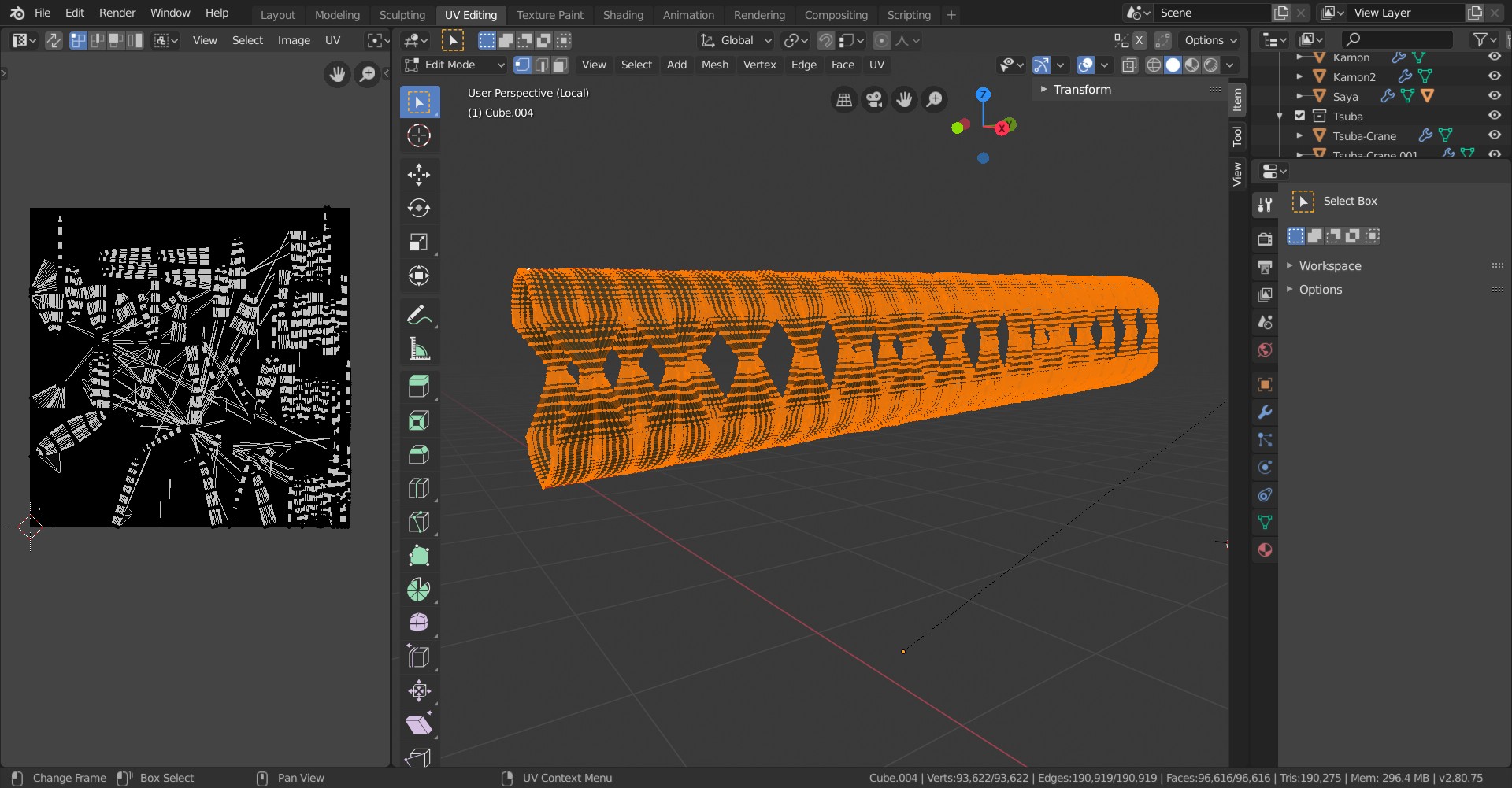

    I have a problem with the handle.
    I have two versions of it : One with all modifiers applied, and a very complex geometry, which when trying to unwrap results in a total nightmarish mess…

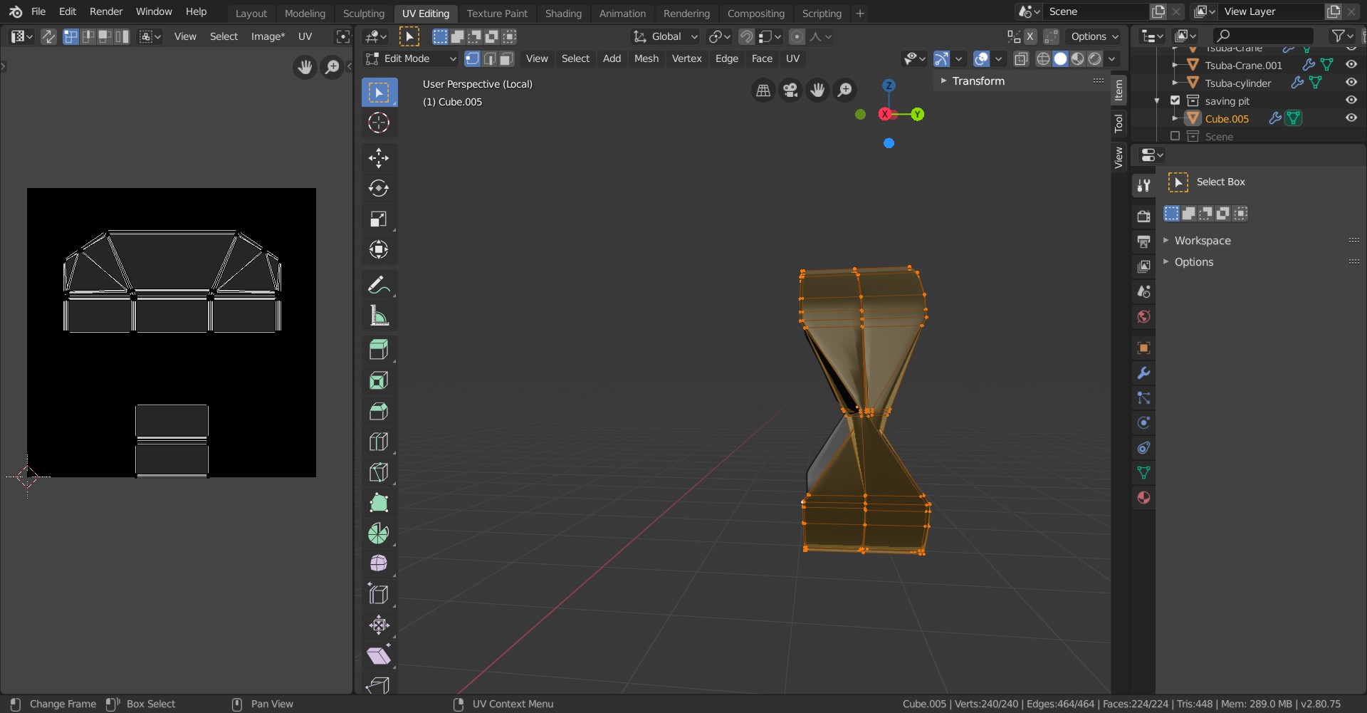

    And I have saved the original, before any application of modifiers, just in case, at the time I wasn’t sure if I should randomize the vertices or not.

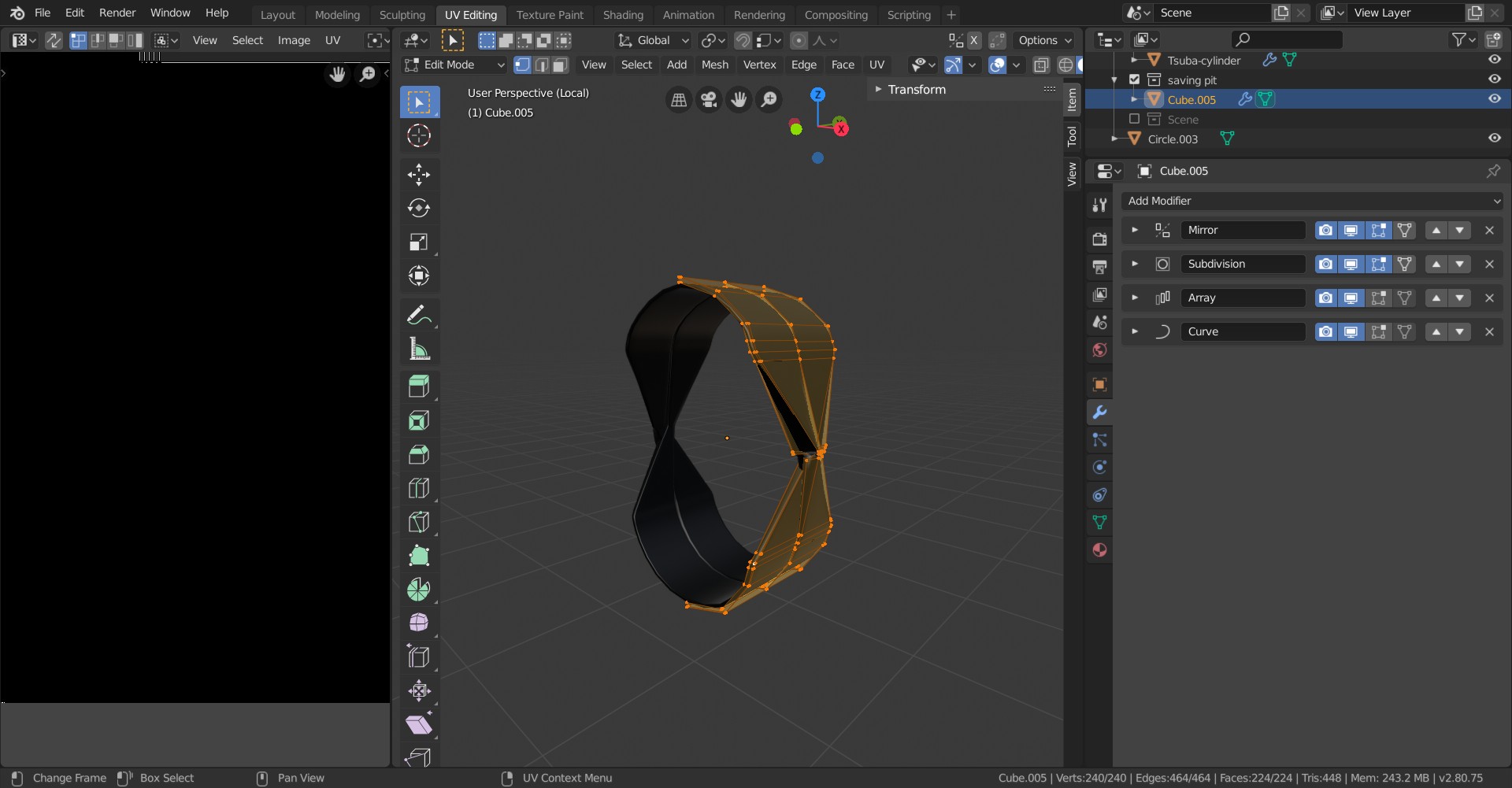

    For reference, here is the modifiers stack.
    Which way would you choose to have a usable UV in the end?
