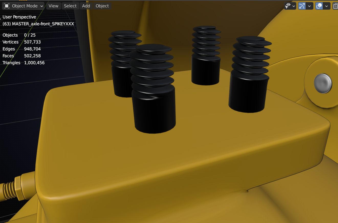

    Made some nicer bolts:
    Also managed to reduce the number of Vertices from almost 800.000 to around 500.000.

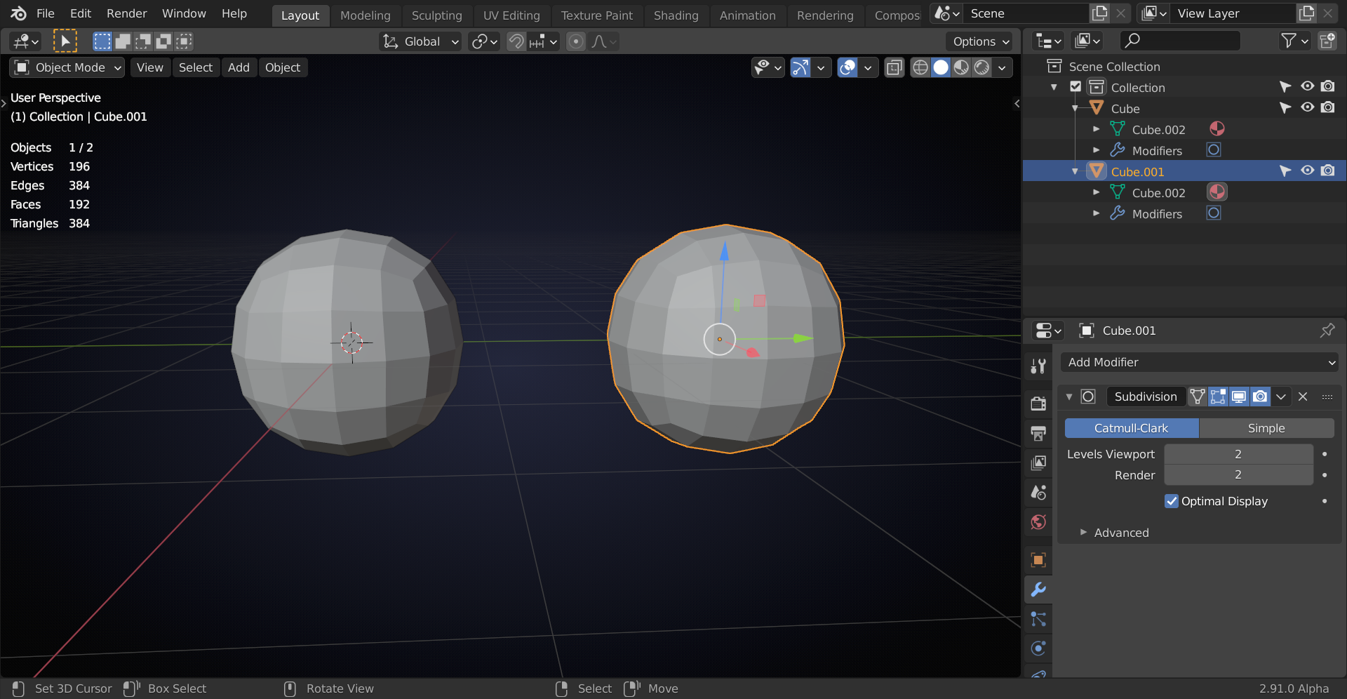

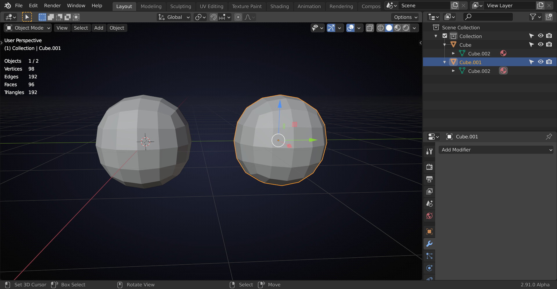

    I made a linked copy of a subdivided Cube, with the Subsurf Modifier applied. The number of Vertices stays the same.
    But when I made a linked copy when the Modifier wasn’t applied, the amount of Vertices doubled:
    It sort of makes sense, that linked copies can have different Modifiers (or does it?), but then I would expect 188 Vertices, because the ‘base’ vertices wouldn’t be ‘doubled’.
    So I tried this with my Axle file and as you can see above the number of verts was reduced drastically.
     But my file size went from 23 to 72 MB!
    It gets worse; the render time went from 4:42 min to 6:06 min. Just to be clear: the version with less geometry but more memory took longer to render!!!
