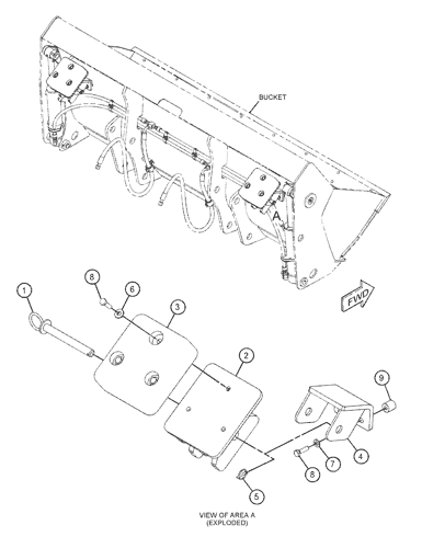

    @pfbourassa I think @blanchsb is correct, the top piece looks like a cover. As for how it is attached, at first look I would say it is hinged, and clipped some how to keep it closed. So I found this image which on the nearside shows this part where the flap is but the far side shows it more to the centre of the bucket, so I’m guessing here, this is under the flap. But I could be wrong. This is obviously not a ‘to scale’ drawing.
    Notice #1 is a pin which passes through the holes on the underside of #2 and also the holes in #4. This doesn’t show the cover but it would suggest from the description on the site optional attachments can be attached here.
