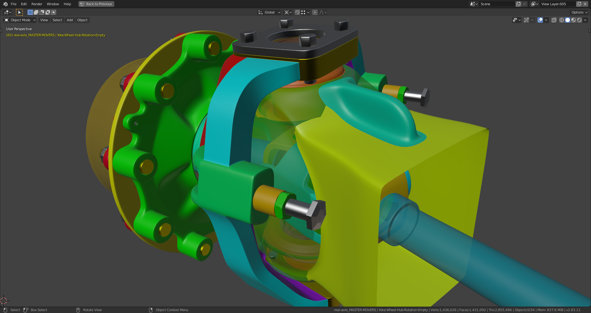

    Is this how the axle end housings are rotated?
    I had to move the yoke (?) closer to the backhoe’s center line and widen the yellow part on the right image half a little bit. I unfortunately don’t know any image showing the real life yoke sizing on positioning.
    Animation is here.
