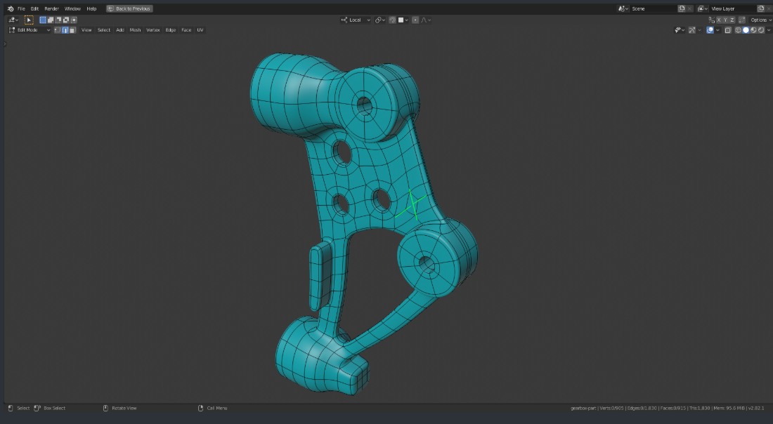

Not sure about all of the 5 sides poles. When you have that many circles close together you can work the number of circle sides to your advantage. Using a 16 sided circle versus an 8. I would say keep them to divisions of 4 in most cases. But I have seen 6 and 12 sided circles work sometimes too. You may just need 16 or more sides to get better edge flow with fewer poles possible or at least get those poles not next to each other (creating more geometry in between them).
Also here is another easy fix. You can remove this one:
