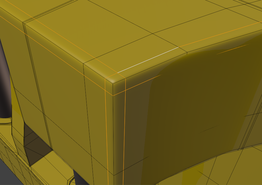

    Looks like you’re really close to finishing, amazing job!
    Only thing is, some edges are really sharp like here:
    Those holding edges are too close I think:

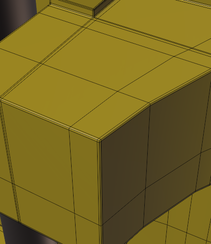

    If you just slide them away from the edges:

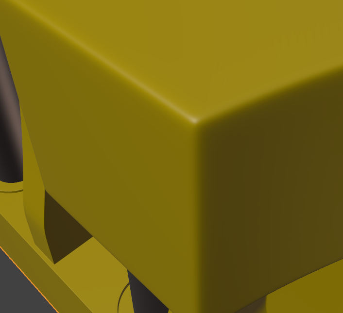

    It will look better and more consistent to the rest:
    Maybe round it out even a bit more, when looking at reference:
