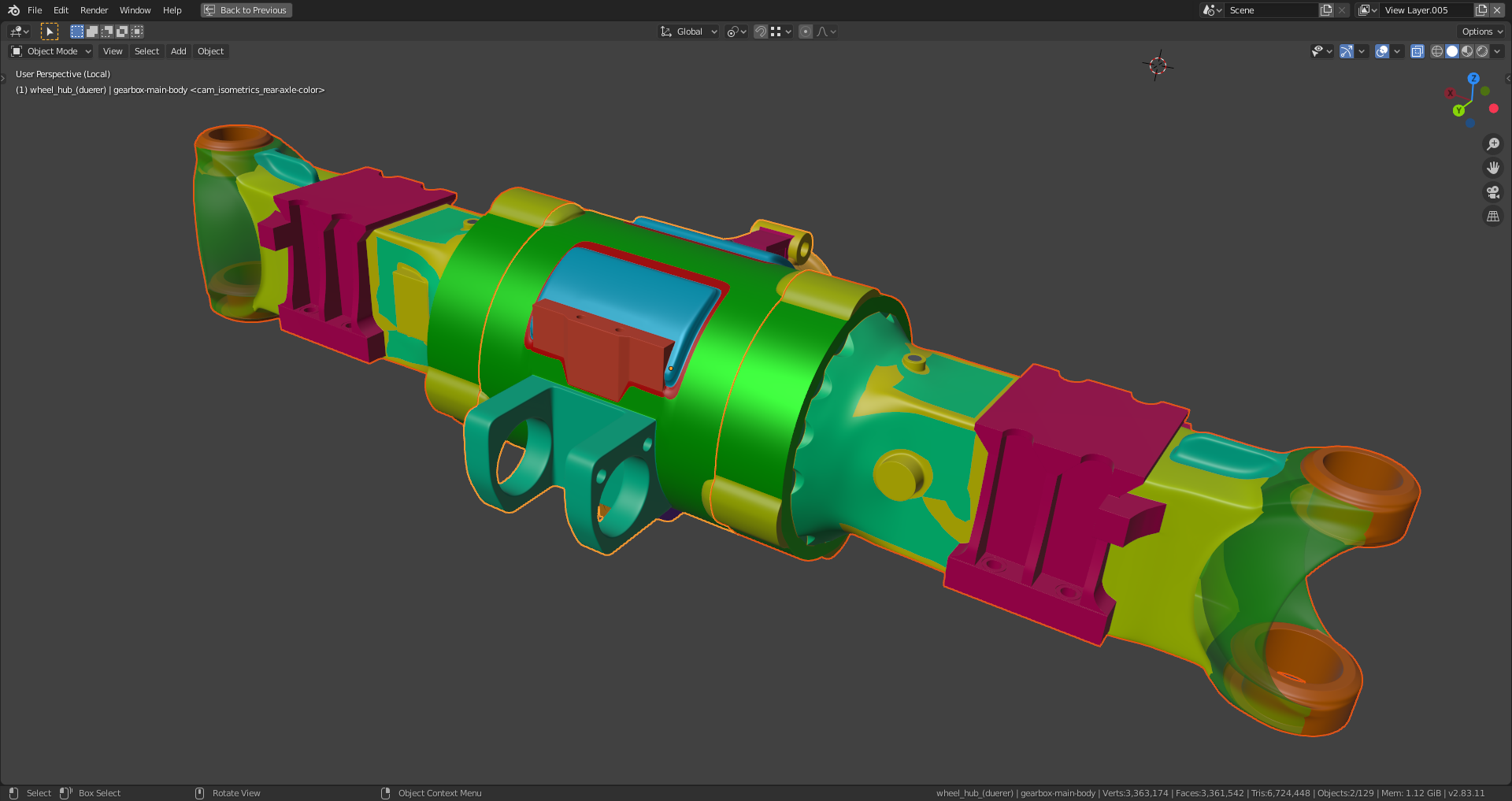

The “Shrinkwrap Modifiers” on the gearbox can only be applied after applying the preceding “Subsurf Modifiers” (Level 2) in order to get the correct shape:
