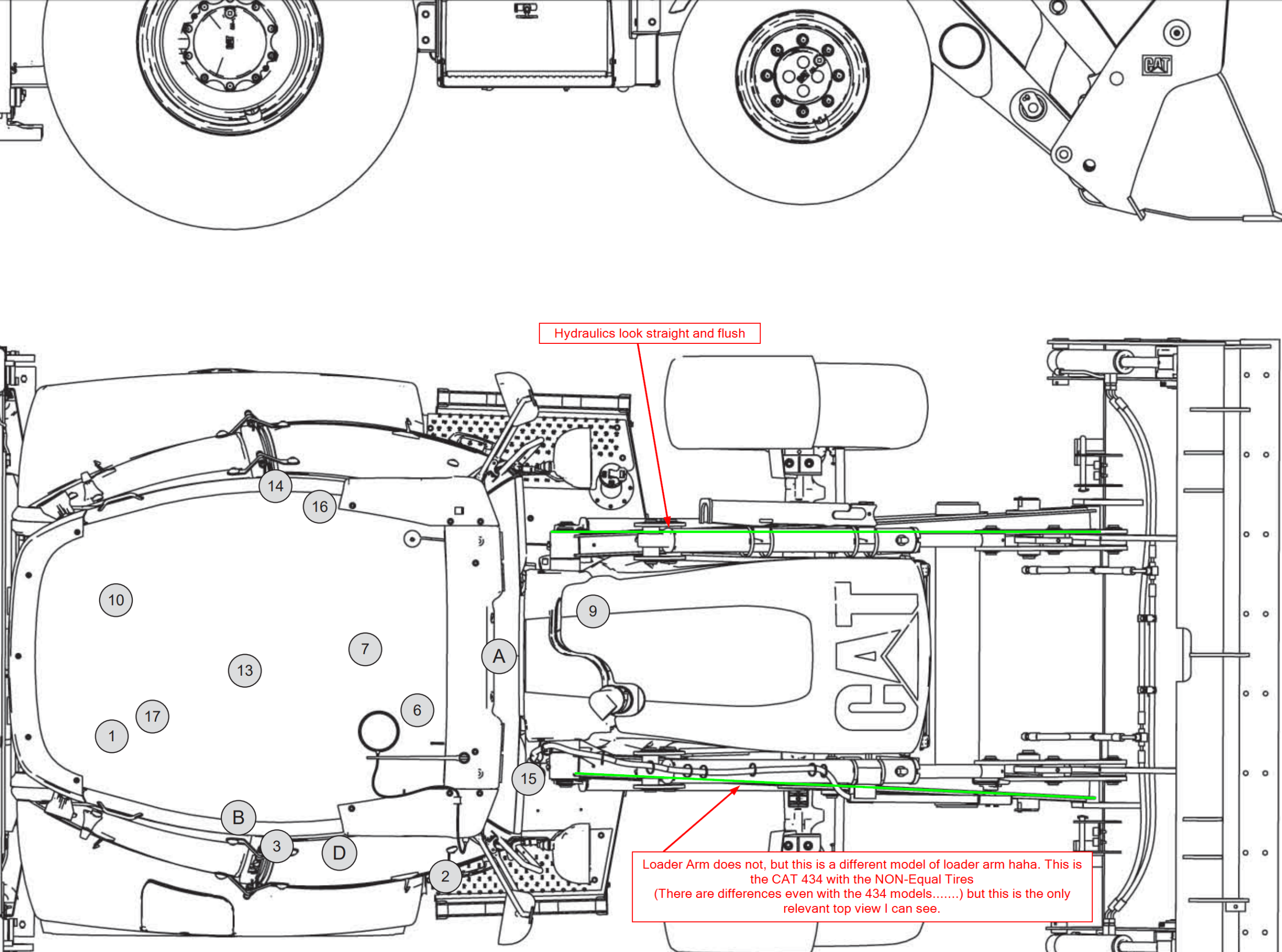

Here’s another viewpoint where I talked about it with things shifting to be centered like people are suggesting and why that obviously is not going to work. I can try to shift stuff over like @pfbourassa Parker has suggested but man all of the reference that I see these top yellow pieces that hug the red piece are really close together. So I am at a loss of what to do unless I widen the loader arms like in this photo
Crap…….I found the issue. The loader arms spread out just like in the picture above………..dun dun dun! I found the loader arm design we are using and it is doing the same thing. I can’t post the picture though. We already have this picture in our forum so I don’t feel bad posting a higher quality one even though it is not exactly our model. Took a look around in my special access and yup. I did it wrong. That’s a bummer. I get to spread that loader arm out now. I’ll see if I can fix it tonight and resubmit.
