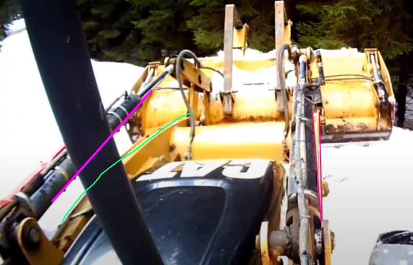

    I promise I don’t mean to be argumentative, but I still think it’s the curve of the loader arm causing visual confusion. With perspective involved it could even look like the left loader arm is angled inward:
    It’s definitely a conundrum trying to determine this without an explicit blueprint / orthographic drawing. BUT in the end, you’re the expert when it comes to these parts. Introducing angles in a mechanical model like this can have consequences if it turns out to be wrong. However sense you’re already mechanically testing how these parts function, you are the only one qualified to make the final call!
    I trust you 100% sir 🤝
