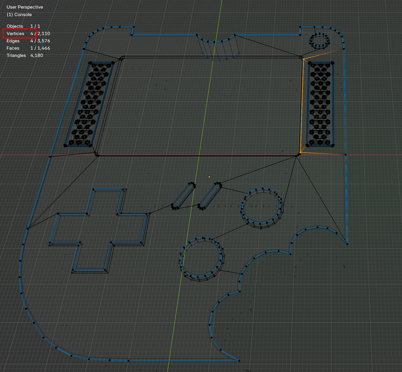

In your new upload, you still have ‘double Vertices’:

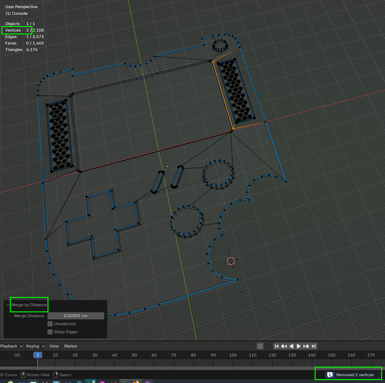

and after Merging:
Then switch to Edge Select Mode and the correct Loop will be Selected, so the Fill works as it should.
