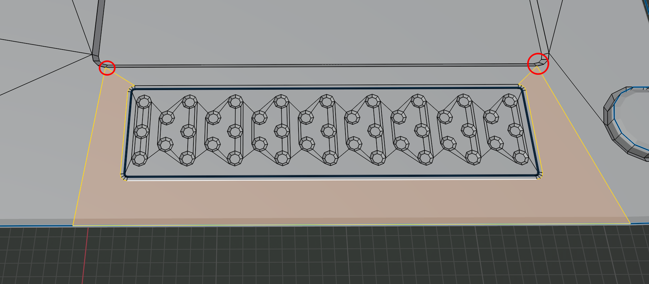

Hi @aworkofmarc ,
You have so-called ‘double Vertices” here:
If you M > Merge > By Distance them, you can Fill correctly (in my Screenshot, I have already Merged them).

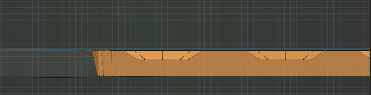

But another thing, your speakers are lower than the top of the console:
