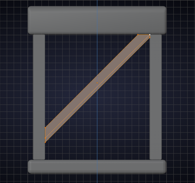

    It’s basically all Cubes. Make each plank by itself, just like you already did. I’d model everything straight and then at the end bend it into shape with a Lattice Modifier.

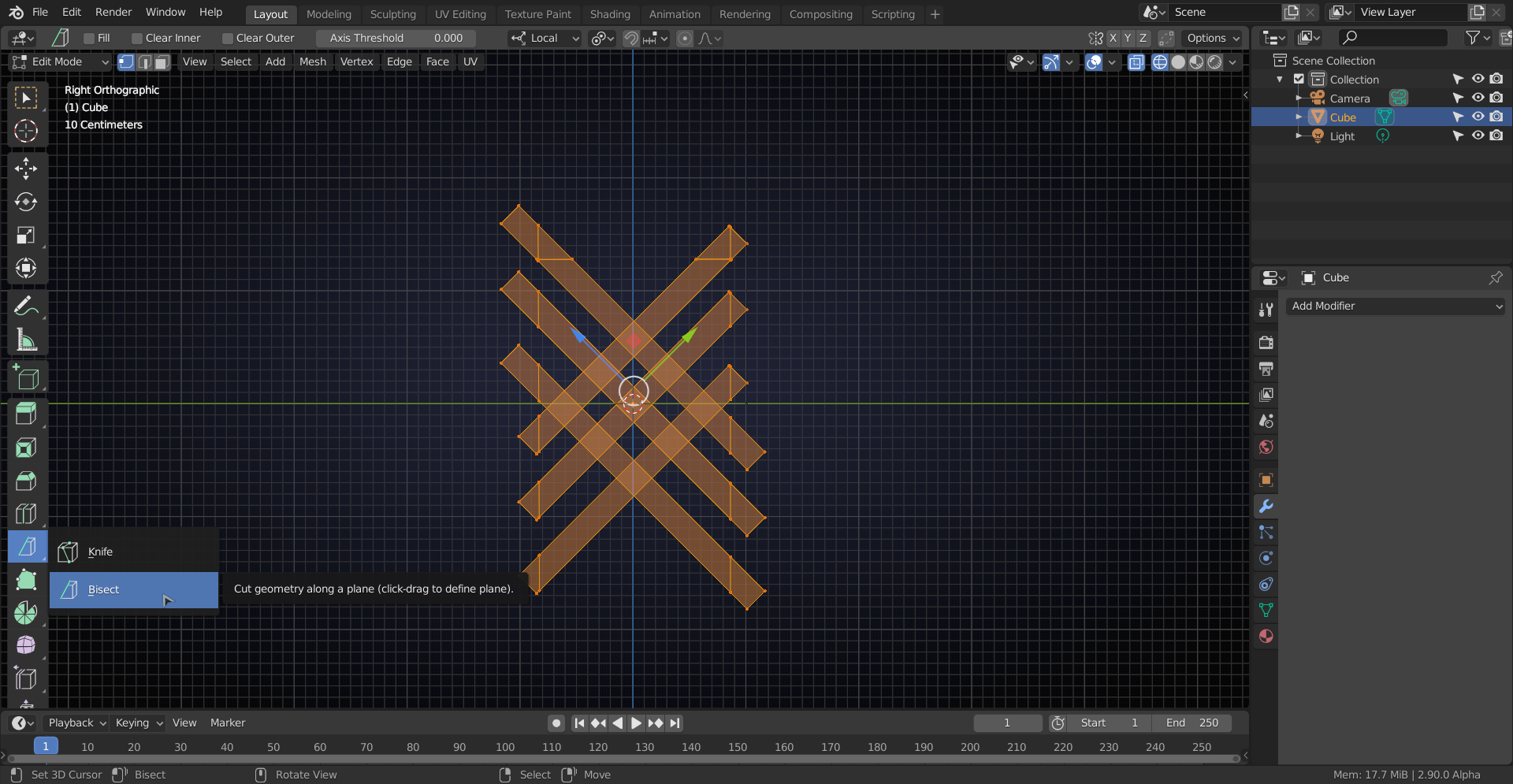

    You can use the Bisect Tool (under the Knife Tool) to cut the planks (make sure all the planks are selected!):

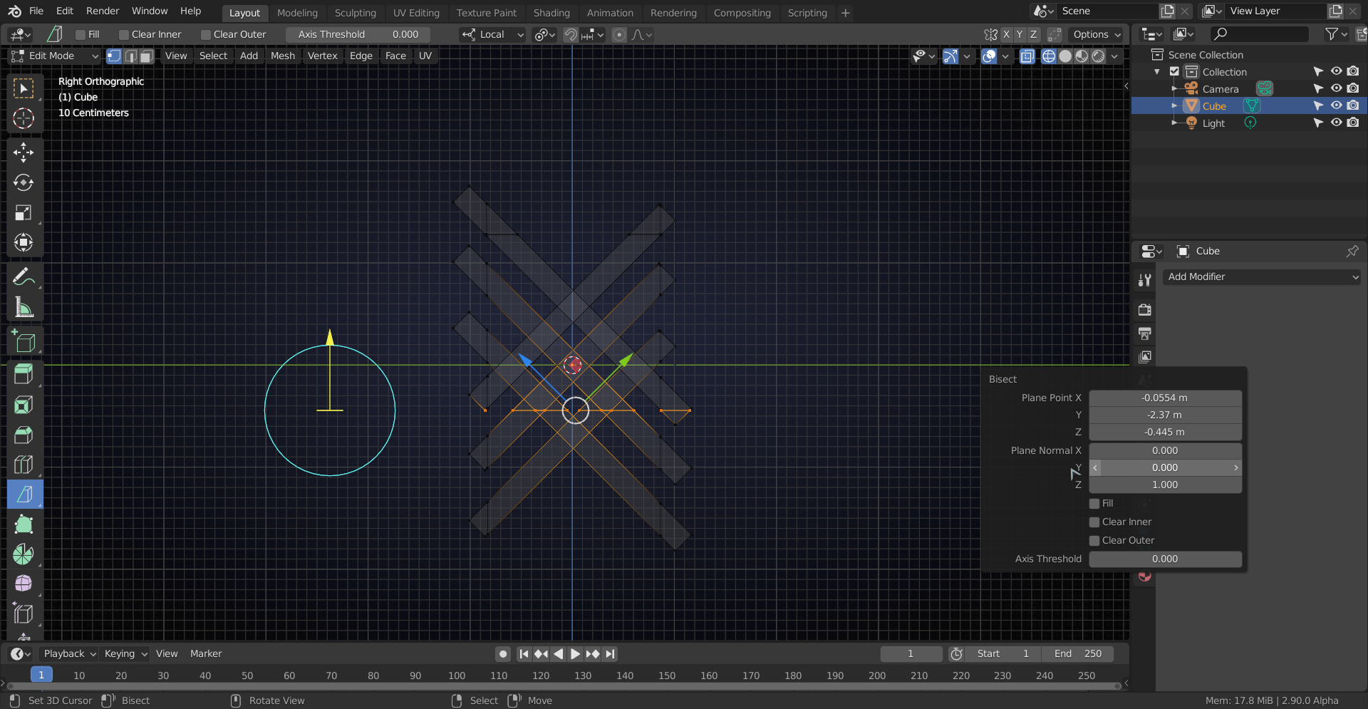

    You can adjust the placing of the cutting plane with the yellow arrow and get it completely horizontal or vertical with the Plane Normal Settings:

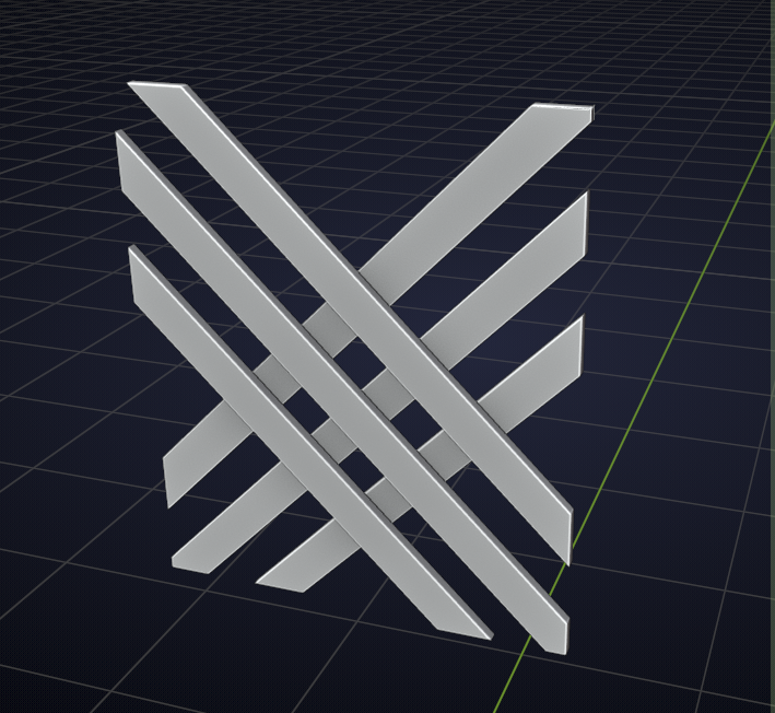

    Did this without looking at your reference, but the technique also applies there:
