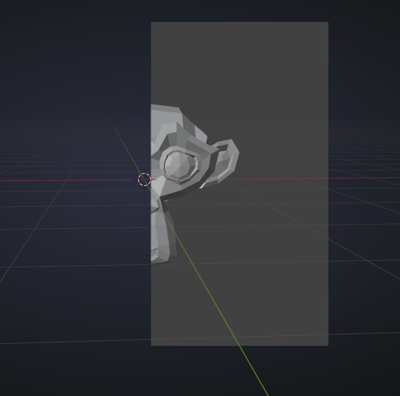

    Hard to tell from the screenshot, but it almost looks like you accidentally used the ALT+B hotkey combo. This “clips” the view:
    and when you change the viewpoint now:
    Actually very handy in some situations! (This doesn’t affect Rendered or Material Preview Mode…)
    You can restore from that by again pressing ALT+B.
