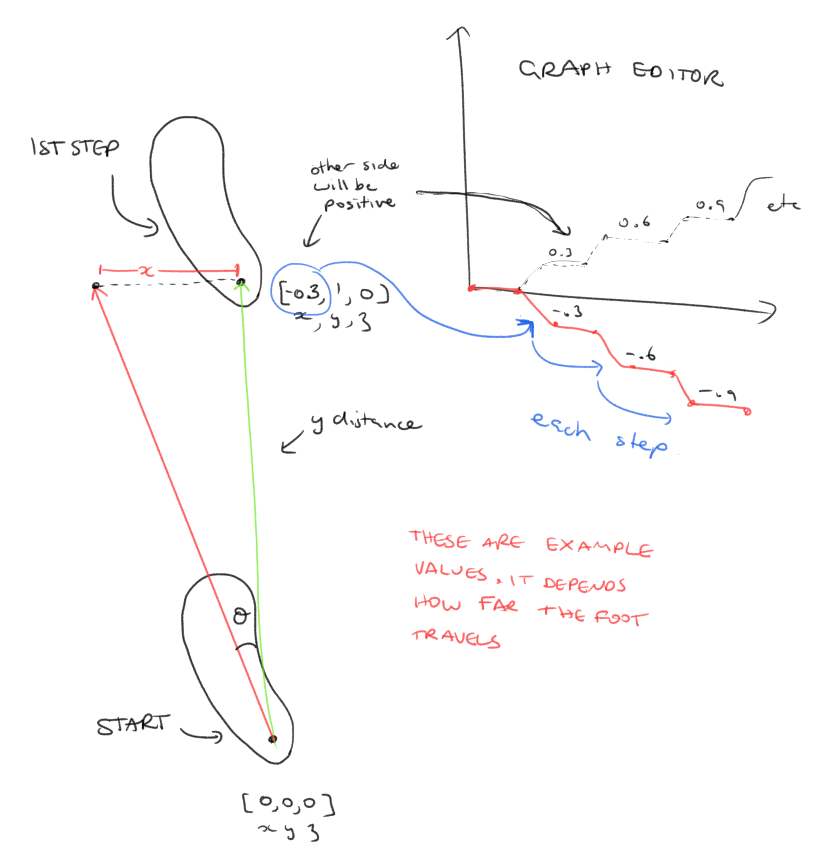

Maybe this drawing will help.
Note that these values are just for demonstration purposes.
But the key thing is you want the x loc offset value to accumulate.
So if it is 0.3 on the first step, then it is 0.6 on the next etc.
Does this make sense?
