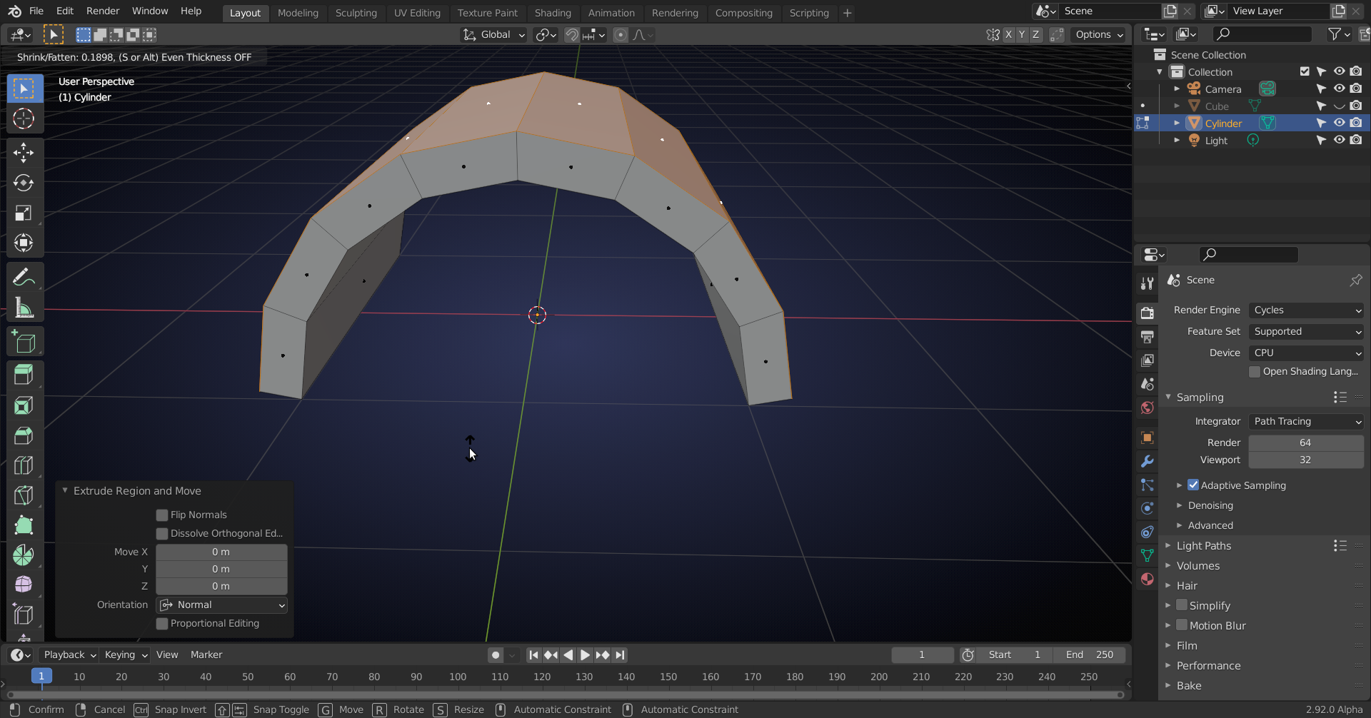

    The thing is, you have too much selected!
    This is how it should be. Look at the white dots (selected, in your case: orange) and the black dots (unselected):
    Now this happens when scaling (as it should):

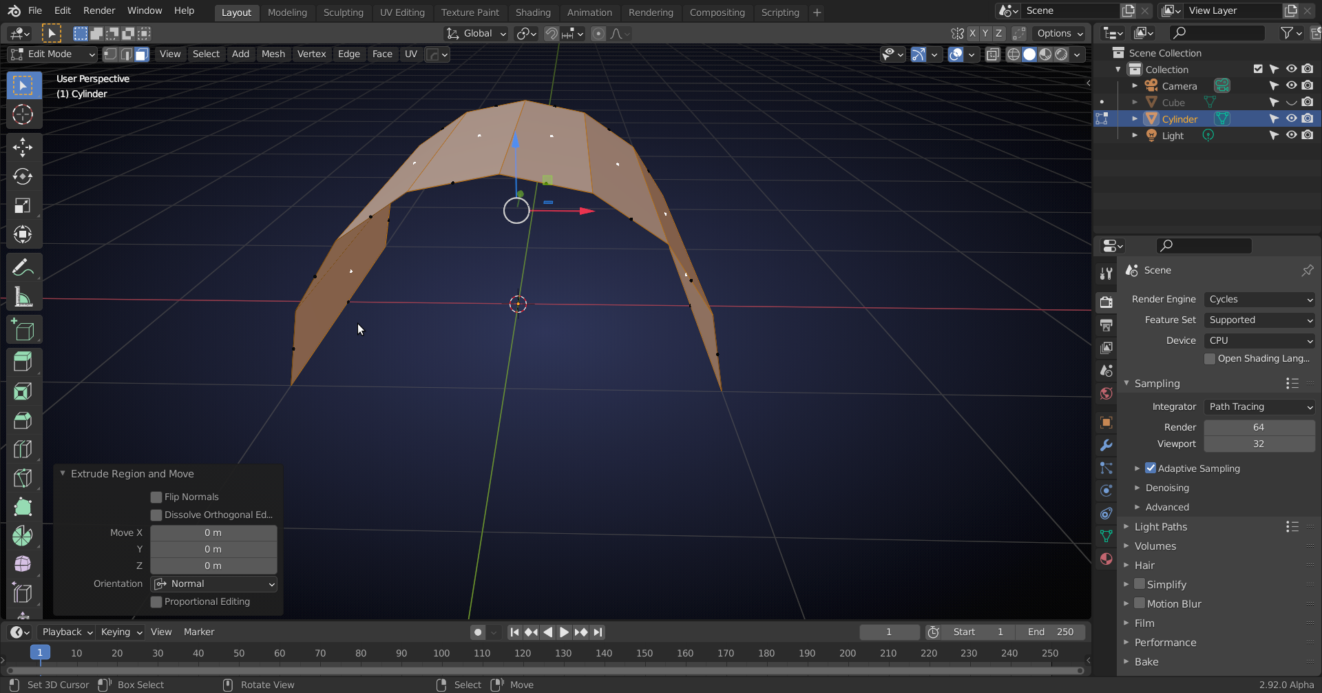

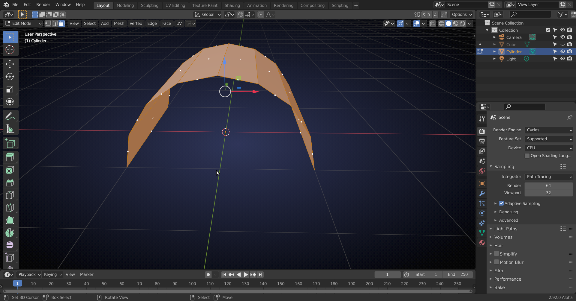

    But you must have Extruded, canceled (which doesn’t cancel the extrusion, only the ‘Move” that would normally follow the Extrude) and then selected ‘everything’ and extruded again:

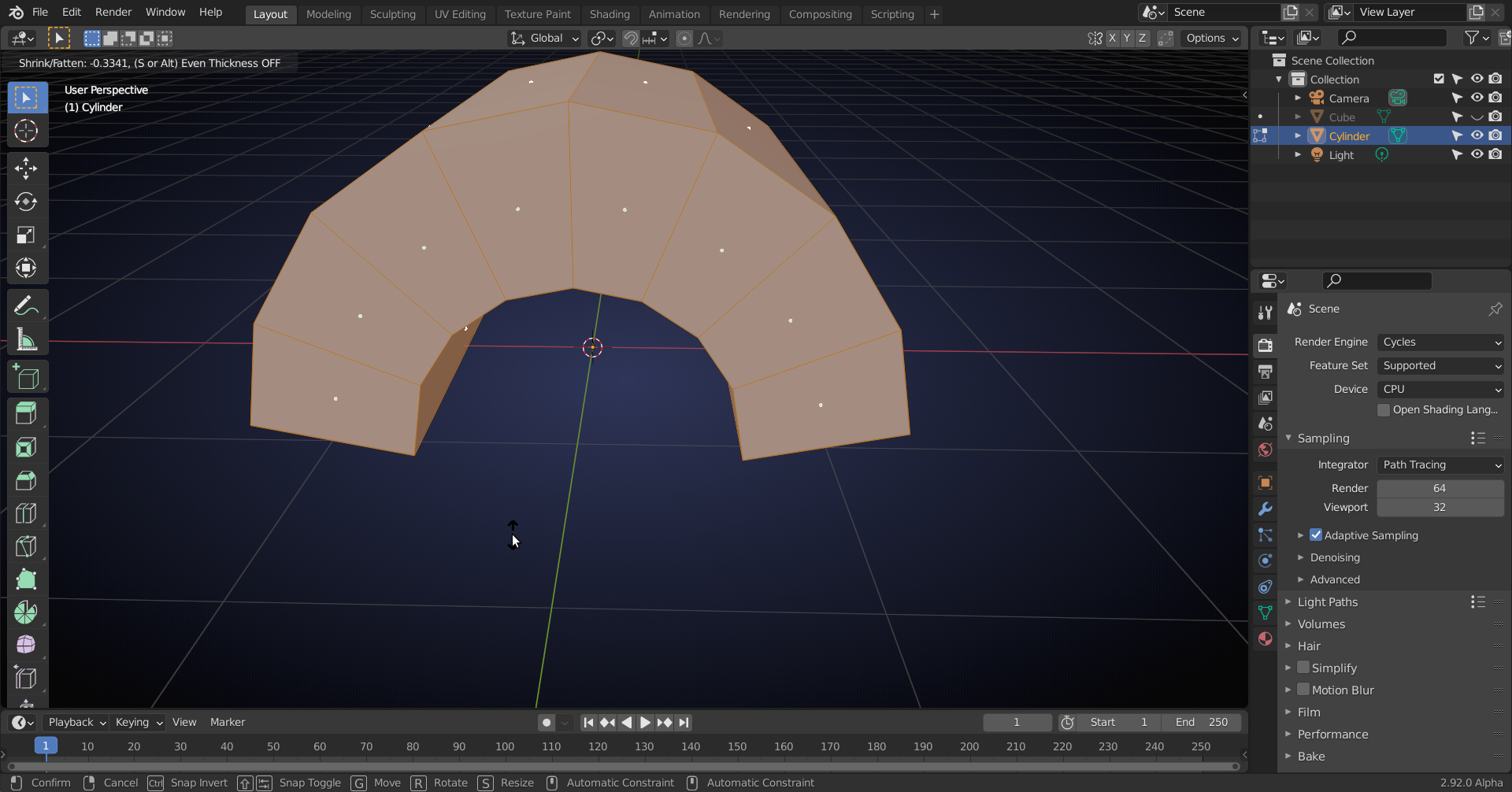

    Look at all the white dots (selected Faces). When Scaling now, this happens:
